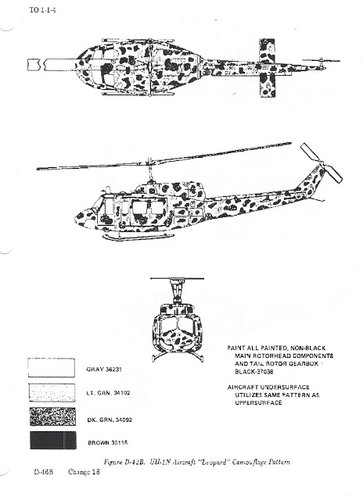

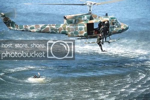

Any details on this non standard paint job?
I am not sure why the scheme was used specifically with the J-CATCH program, however the camo scheme is reminiscent of the 'duck hunter' camo developed as US M1942 used by commandos in WWII. Early US Army Special Forces training exercises used 'aggressor' soldiers in duck hunter camo to represent the enemy or indigenous forces and the camo was also seen in Vietnam among LRRP and SF personnel. I suspect that the choice for the J-CATCH scheme may have emanated from that experience. However, that is speculation on my part.
Agree - does not look like the friendly helicopters.
Looks like the "Leopard" scheme (see below). I have read that several special operations UH-1s and CH-3s carried this scheme but have only seen UH-1s to date.
615965 615966
View attachment 615965View attachment 615966

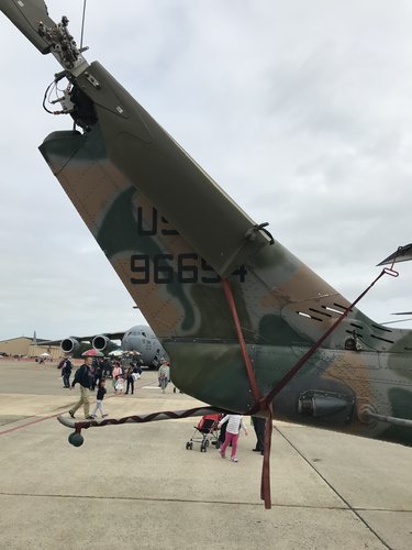

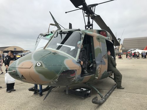

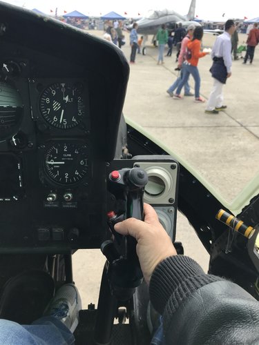

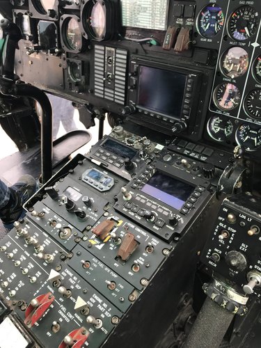

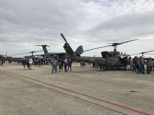

I saw and sat in one of these former 20th SOS ‘Green Hornet’ UH-1N J-Catch at J-B Andrews Air & Space Expo 2019 (now as 23rd FTS a/c out of Fort Rucker) back in May. So here are my photos below.
Cheers

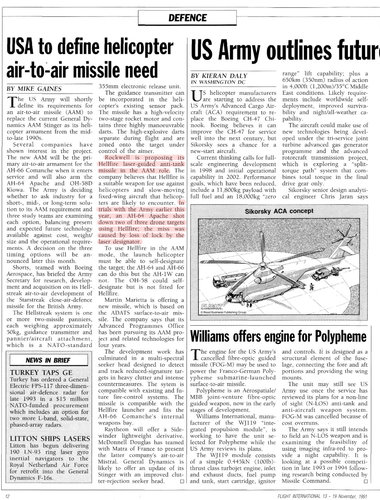

Army and Lockheed Martin needed to be added in AGM-114K (first Hellfire II family product) the side look laser target sensor (as on AAMs) and as result would have universal munition - effective against hard, air targets and soft targets (today height of burst sensor has only AGM-114R2 - late 2010s) AAM Hellfire.jpg
In 2015 US Army funding purchase 2 CATM-9X Block II and 7 special air training Sidewinder missiles (without details)
I'm think purpose was some tests Apache air-to-air capability

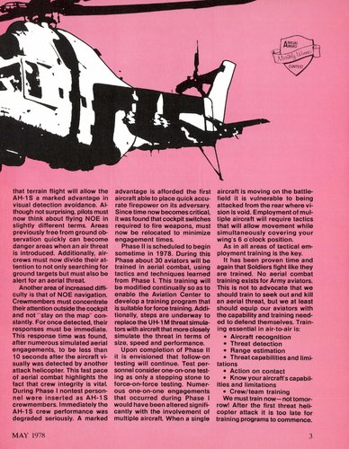

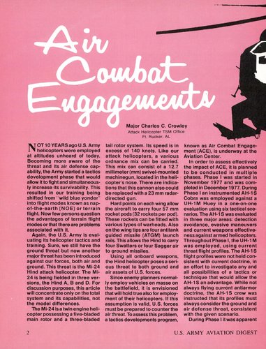

1978 Article on ACE from Aviation Digest. Phase II of ACE mentioned in the article may be J-Catch.
