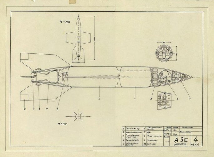

Sometimes you find things at home that you've forgotten .On one of my hard drives,i found this, but from where,i downloaded it . nada.

Ummm... no. The A-4 (and thus A-9) rocket was only 1.65 meters in diameter. No packing a manned capsule like that into it. The dimensions are hard to read, but this thing seems to claim a diameter in excess of 2 meters.
It's fictional.

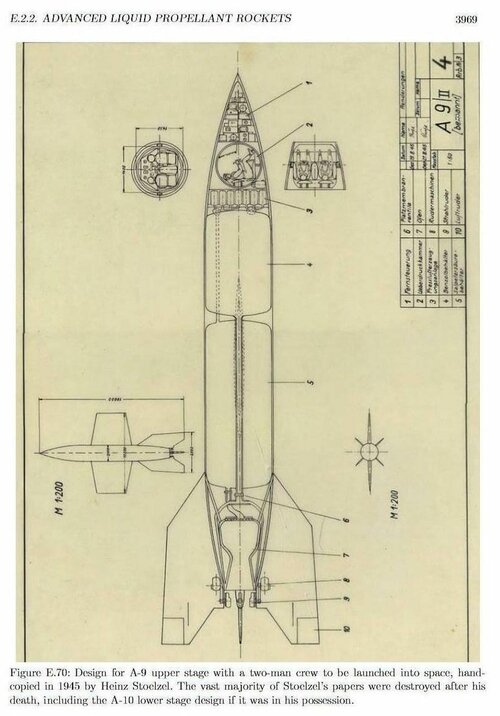

Following my post #4 concerning an A9 II Bemannt, here is a Drawing of two-men A9-II reported by Heinz Stoelzel a captain in the Wehrmacht assigned to the Rocket-Bomb Plant at Peenemuende and quoted by (Todd H.Rider page 3969 in his book "Forgotten Creators"), this bibliographic reference was introduced to the forum by an SPF member "williamjpellas". See threads "Prüfstand XII: submarine launched V-2 rockets".
Yeah that book was thoroughly demolished in another thread as being completely unreliable and even intentionally misleading and fabricated.
Considering that von Braun got arrested due to rumors that he is more interested in spaceflight, thah in ballistic missiles, the mere idea that Penemunde could do any work on manned suborbital flight is... frankly, absurd.
The only - slight - possibility this picture could be real, is that its a post-war concept, quickly invented by some German engineer to make himself appear more valuable for Americans/Russians.

Stoelzel was actually a captain/lieutenant of the Luftwaffe (ok, still a branch of the Wehrmacht ;) ), who presented a concept of an unguided AA rocket in 1942. Some limited tests of his rockets, which were developed by Stoelzel without appropriate support or control from higher instances, were conducted in mid 1943 in HAP, then he was allegedly sent to the front for combat trials, which were completely unsuccessfull and the project was halted.
It should be noted, that a lot of so-called "German next generation rockets" could be actually a post-war concepts. German engineers tried rather desperatedly to make themselves looks valuable for US/USSR. Presenting some futuristic-looking concept, and claiming that "we worked on it before the war end, but all data was captured by the other guys, so you better hurry giving me a working place" was a simplest way to attract interest.
A good example is Hugo Schmeisser, who presented himself to USSR as some kind of genius gunsmith. Only much later Soviet engineers found with annoyance, that Hugo have very little valuable knowledge, and besides some consultations about industrial processes, he is essentially useless
But Schmeisser was a well known personality at least. :)
Stoelzel was, in turn, just no-one, so he could easily want to invent the most incredible projects, just to be considered as a valuable designer by the Allies. Another such a person, we discussed some time ago, was Nils Larsson with his Zugspitze rocket - specifications and performance of the rocket, as he stated it, are such full of nonsense, I'm really amazed no-one has immediately noticed it.
Exactly. It's a perfectly plausible explanation, that actually explains a lot of puzzling irregularities, like abovementioned -

In the FWIW category, the drawing appears to be dated in August 1945...
About the same time a lot of Germans were inflating their resumes as a way to get in good with the US Army. It was starting around this time that von Braun started making claims about the A-11 and A-12 and a space station... claims that, to my knowledge, have never been backed up with verified wartime documentation or even testimonials from other German rocketeers.
Exactly.
