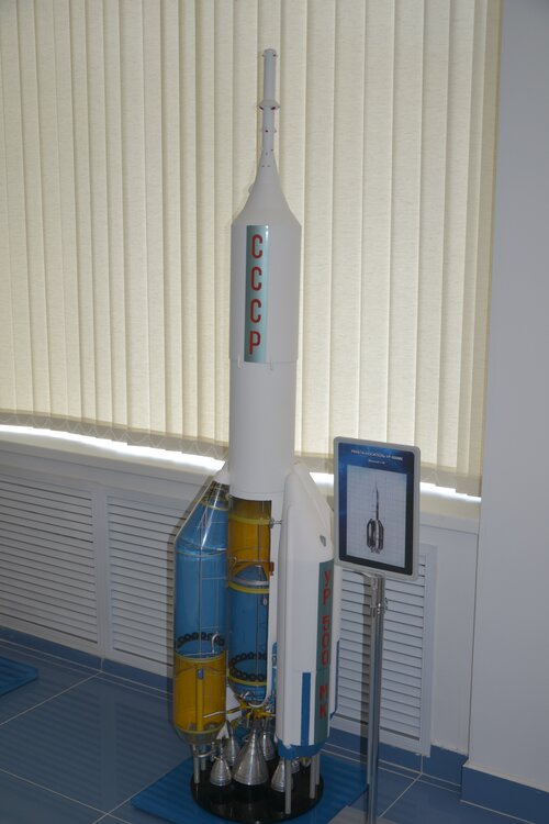

in 1975 Chelomei proposed a low cost alternative to Zenit program
a Modular rocket build from UR-500 parts but using NK-33 engine and Lox/ Kerosine fuel!
the UR-500MK were proposed in two version the 11K98 and 11K99.
11K98 with six lateral stages: 30 tons in 200 km in 51° orbit
11K98 with three lateral stages: 15 tons in 200 km in 51° orbit
from data and size of UR-500 parts i got some thing that look like attach picture
can some one confirm me this ?
