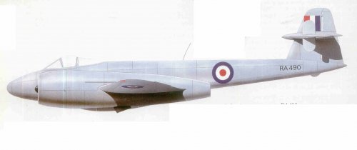

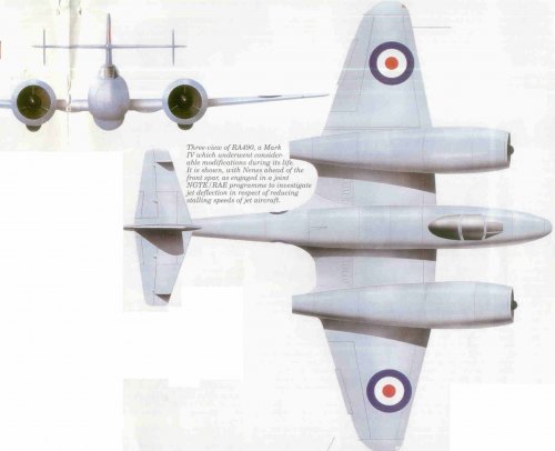

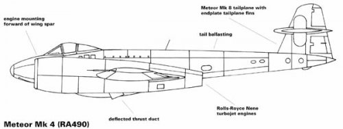

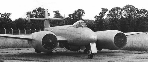

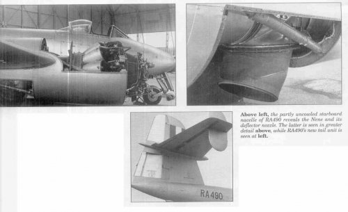

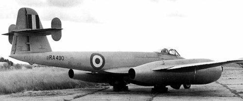

I found mention of a Gloster Meteor (F.4) extensively modified in 1954 with Nene engines with thrust deflectors. Other changes were to go to old-style wings and the F.8 tail unit.
http://www.vectorsite.net/avmeteor.html#m5
I have a few questions;
Does anyone have any pictures or an explanation of the deflectors?
The text doesn't make it clear whether the delfectors are variable geometry or fixed, I assume they are fixed. In this case why didn't they just angle the jet pipe downards (as in the Aerfer Sagittario/Ariete)
How hard is it to fit Nene engines into the Meteor? Obviously it was possible as with the above but why was the Nene resized to Derwent V if the Nene fit itself?
