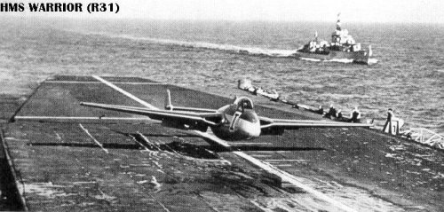

Once I've read about at least one experiment conducted by British with a DH100 Vampire without landing gears and an Aircraft Carrier (but I don't remember the name) with flight deck filled with a sort of rubber in order to mitigate the impact.
It seems that the aircraft didn't suffer any damage, due to this unconventional landing technique, but the system was found too impractical to be adopted by RN.

Fot the first tests, a concrete filled Hotspur glider was used, landing
on a rubber landing strip at Farnborough. The a DH Sea Vampire F.21
was modified and flight tested by Eric Brown, at first again on the land
based installation, until November 1948, when the HMS Warrior was fitted
with a rubber deck aft of the island. Eric Brown described the landings
as succesful, with the exception of the very first, which was "hairy" ...

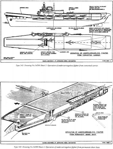

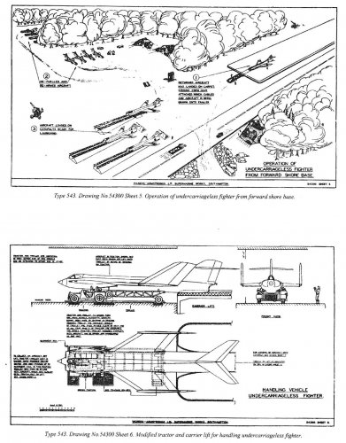

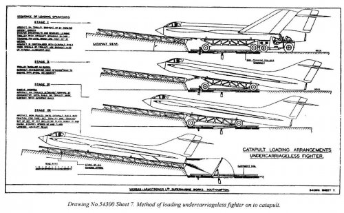

Some information on the proposed systems for use in conjunction with the Supermarine Type 543.
Many thanks GTX ! Wasn't aware of the two storeyed flight deck before ! Suitable for fighters,
but bomber/attack a/c would have needed internal weapons carriage, I think.
Some of the history can be found here (pages 89 - 98 / PDF pgs 106-115) Among other things, there was an interesting connection to the development of the angled deck.

Interesting 'what if' to replace traps and cats. If this had gotten up and fitted to all carriers does this mean I wouldn't have an "Order of the Hook" but rather an "Order of the Bounce"!
Surely one of the big limitations of this approach is how to handle the aircraft on the deck (or on the training airfield). Purpose built trolleys and tugs are all well and fine, but an aircraft with its own wheels can be towed or pushed by a wide range of vehicles - or assembled man power. It can also maneuver quite nicely under its own power. All this is lost when the wheels are removed.

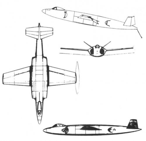

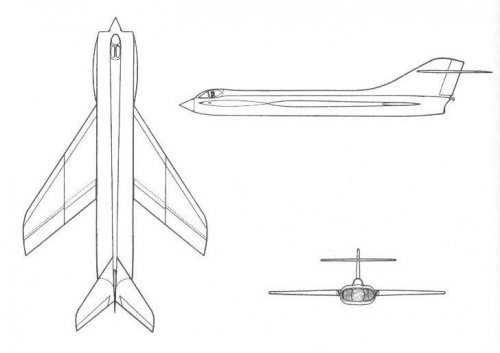

Hi! Type 543 three side view. And Sea Vampire carrier landing test video.
http://blog.livedoor.jp/janome_gotyou/archives/cat_136375.html
https://www.youtube.com/watch?v=f7Lu6LEQ0zo
https://www.youtube.com/watch?v=i0DDkzS6p7E
  • The pilot made the landing by the world's first jet aircraft in 1945, Eric Winkle Brown..jpg
