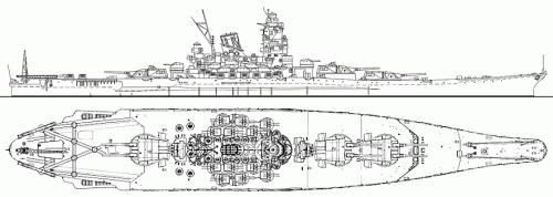

Artist impressions of Design A-150 or "Super Yamato" class battleship. Generally similar to the Yamato-class battleship, but with a main battery of six 510-mm/45-caliber guns and a dual purpose anti-aircraft battery with high-performance 100-mm/65-caliber guns.
Design work was completed in 1941. At least one 510-mm gun was manufactured at Kure Naval Yard in early 1941. The armor-piercing shell would have weighed 1,900 kilograms. The powder bags--eight for each round--would have been too heavy for loading, and automatic transfer and loading devices were under development.
Warship Number 798 would have been built at Yokosuka in the Shinano dock. Warship Number 799 at Kure in the Yamato dock, after the fourth Yamato-class battleship cleared the dock. The ships were scheduled to be laid down in late 1941 or early 1942 and launched three years later, with a total building period of five years.
Source: Battleships: Axis and Neutral Battleships in World War II by William H. Garzke and Robert O. Dulin, Jr., United States Naval Institute, 1990.
http://en.wikipedia.org/wiki/Design_A-150_battleship
http://www.watakan.com/works/yamato/a150.html

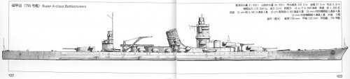

Design B-65 was the Imperial Japanese Navy response to the US Navy's Alaska-class battlecruiser. Preliminary design work was completed by September 1940 and two ships of the class were planned. Main battery of nine 310-mm guns and a displacement of 35,000 metric tons, the general characteristics of this design were very similar to the Alaska-class.
General Characteristics
Type: Super Type A cruiser
Displacement: Standard: 31,905 t (31,401 long tons)
Full-load: 35,000 t (34,000 long tons)
Length: 240 m (790 ft) length at the waterline
246.2 m (808 ft) length overall
Beam: 27.2 m (89 ft)[1]
Draft: 8.8 m (29 ft) (trial)[1]
Propulsion: Four sets of geared turbines and eight Kampon boilers would yield 170,000 metric horsepower (167,674 shaft horsepower); this would have been able to drive the ship at 34 kn (39 mph; 63 km/h)
Endurance: 8,000 mi (13,000 km) at 18 kn (21 mph; 33 km/h)
Armament: 9 × 310 mm (12.2 in)/50 caliber guns (3×3)
16 × 100 mm (3.9 in)/65 caliber dual-purpose guns (8×2)
12 × 25 mm (1 in) anti-aircraft guns (6×2)
4 × 13 mm (0.51 in) machine guns (2×2)
8 × 610 mm (24 in) torpedo tubes (4×2)
Armor: Sources do not give any specifics outside of a 190 mm (7.5 in) side belt sloped at 20° and 125 mm (4.9 in) deck

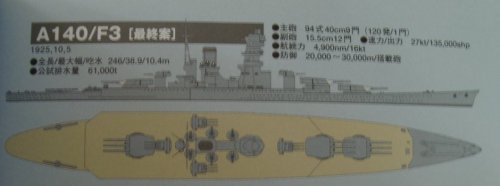

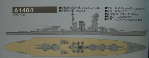

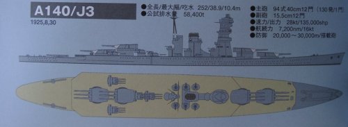

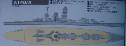

Artist impressions of Design A-140 project design concepts. The Design A-140 project would become the Yamato-class battleship.

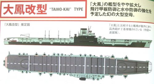

NEVER BUILT 'NEXT' - TAIHO CLASS CARRIERS
By Noriki Suzuki
IJN carriers were very successful in the early stages of the war but were defeated in June 1942 at Midway, when four carriers were lost. So serious was the loss that the IJN modified its wartime supply plan 'Maru-Go' (Circle Five) to 'Kai-Maru-Go' (Revised Circle Five), intending to reinforce its air strike capability. The "Next-TAIHO class carriers" were a part of that plan. TAIHO was the only carrier included in 'Maru-Yon' (Circle Four) shipbuilding plan, featuring heavy armor, quite untypical for traditional IJN carriers.
The 'Next-TAIHO' class carrier was to be a larger, advanced version of TAIHO. TAIHO's displacement was 34,200 tons (trials); 'Next-TAIHO' was to be 35,800 tons and 4 meters longer. TAIHO's flight deck length was 257.5 meters and 'Next-TAIHO' 261.5 meters. TAIHO had six 100mm twin AA guns Type 98; 'Next-TAIHO' was designed to have eight Type 98s as suggested by TAIHO gun crews.
Another improvement was the revised anti-torpedo protection. Recognizing the development of enemy torpedo power, 'Next-TAIHO' had a well-designed under-water protection structure, enough to withstand a 350kg torpedo explosion. Again learning from Midway the electrically powered bucket chain hoists for bombs and torpedoes, connected flight deck and magazine directly. According to Revised Circle Five plan, the 'Next-TAIHO' was designed under basic design G-15.
The plan was to build five of these ships, numbered 5021 to 5025 at the following shipyards:
No.5021 at Kure Navy Yard
No.5022 at Kawasaki Kobe Yard
No.5023 at Mitsubishi Nagasaki Yard
No.5024 at Yokosuka Navy Yard
No.5025 at Kure Navy Yard
However, the war situation prohibited building such high-quality giant flattops that needed too much tooling. Mass-produced medium carriers, with lesser attack capability but needing less building work were required. Therefore IJN authorities decided to build the UNRYU class prior to 'next-TAIHO' according to the same Revised Circle Five plan. UNRYU's design was based on HIRYU but featured some improvements. With the worsening war situation, the shortage of materials prevented any ship keel lay and abandoned their building.
Via MilitaryPhotos.net:
http://www.youtube.com/watch?v=po0mht6LcwA&feature=player_embedded

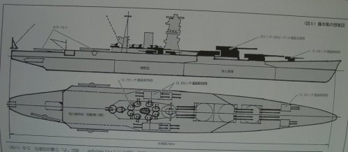

Triton said:
Design A-220 or Fujimoto "Dream Battleship".
While the Fujimoto Dream Battleship was a real design from 1936 it's designation of A-220 is purely fictional

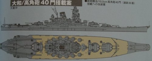

And here are my interpretation of the Yamato Variants:
Yamato Class (3 ships):
Improved Yamato (or as I call Them Yamato-Kai Class) (Last two ships of the Yamato class to a different design) 3x2 51cm 2x3 15.5cm
Version A: (My Suggestion with still the 127mm Type 89 AA guns)
Version B: (real proposal with 10cm Type 98 AA Guns)
A-150 aka Super Yamato with 4x2 51cm and "Many" 10cm Type 98 AA Guns:
