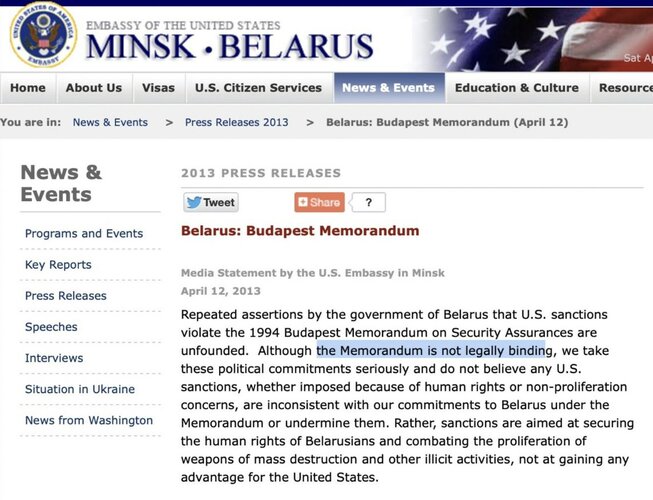

No , US basically went on disarming former soviet states to prevent spread of nuclear weapons to 'rouge' players ,they also hired scientists working on NBC waepons and sustained chem and biolabs for same reason , Ukraine being super broke sold weapons stationed on its soil over which it did not exercise operational control, nuke keys were in Kremlin pre 1991 and post 1991. So in reality Ukraine sold of someone else nuclear waste it could not use or afford to maintain and Chernobil was still fresh on their minds.
US contracted Moscow to process the nukes into fuel for US reactors , 1/5 of which still run on this fuel. Russians also bought or cleared debts with some of Tu-160 while rest of bomber fleets were cut up as were thousands of missiles .Meanwhile worlds arms bazzar opened in Ukraine home to 3rd largest conventional arms arsenal ( soviets left all the gear there) , lord or war and likes operated mainly in Ukraine .Ukrainian arms fueled every 3rd world war you could find.
In any case memorandum was like trust us bro , worthless , non legally binding and US broke it a year or two later by sanctioning Belarus and Ukraine. So anyone pointing to it as some holly grail document is just being stupid. Post 1991 ex soviet union was ripe for pilagining and that is exactly what happened everyone and their aunt went on a pilaging spree , US banksters and economists literally created the oligarchy when they auctioned state assets for peanuts to select elites with no money , wrote Russian Constitution etc...... ran Yeltsin like a pupet.
