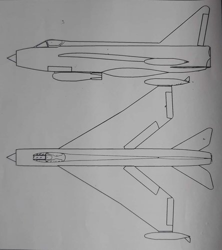

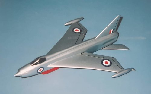

Where are you putting the bomb, on the lightning? I recall the only pylons being on top of the wings? Maybe saw a pic with sneb pods? But surely you would need these for fuel? ditch the guns and have a custom 'pod'?
there were proposals for EE. Lightning carrying a tactical weapon on underwing pylon or semi recessed (P.18)
Probably a recession in a modified belly tank would be preferred. Leaving the wings for fuel and conventional weapons.
