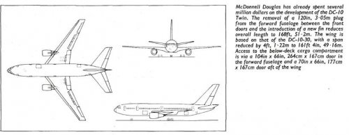

Just another picture from Aviation Week 1972 :

Not sure about all that... although it would be interesting to look at the claimed performance numbers.
Logically, compared with the A300 - which had a wing sized for fairly short sectors but eventually was developed in the high-gross B4 version to accomplish the key US transcon mission - the DC-10 Twin would have had a larger, heavier wing (sized for the trijet) and bigger tail (relatively shorter body, since it was 9x versus 8x, and a bigger wing) and everything else, like the main LG, would be heavier unless it was made less common. So you'd expect a higher OEW and given the same thrust, less performance.
Wouldn't the DC-10 twin carry substantially less fuel as it would only need to fuel two engines?
KJ
KJ
With a lower gross weight and only two engines, it could potentially achieve a range extension over the standard DC-10 if it carried the same amount of fuel.
But then it would have to get off the ground with the same fuel load, with the same wing, half as much thrust in the critical one-engine-inoperative case and a more asymmetric thrust balance.
Yeah, but it was using the 51,000 lbf CF-6 models while the DC-10-10's which often flew the short range routes only produced between 40,000 lbf and 41,500 lbf. That combined with the lower fuel requirements to only fuel two engines, the smaller shorter fuselage and the need to carry less passengers should be do-able.
Am I wrong?
Kendra Lesnick
In the OEI case you had 51,000 pounds versus 80,000 pounds thrust, and worse asymmetry. And in the cruise given constant sfc and similar thrust, two engines will burn as much fuel as three.
The problem with such drastic cut-down surgery is that (like the 747SP) it is hard to get rid of all the weight that was associated with the original, heavier aircraft without losing the commonality that was the whole point of the exercise to start with. I suspect that, had the DC-10 Twin ever happened, it would have ended up as a very different aircraft.

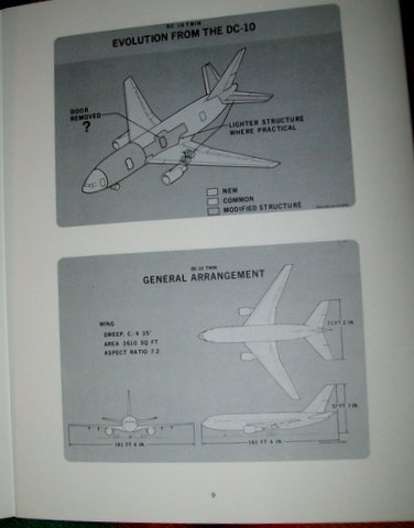

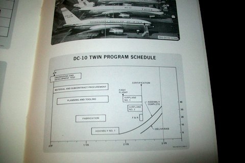

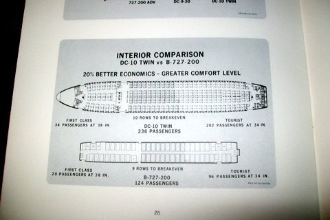

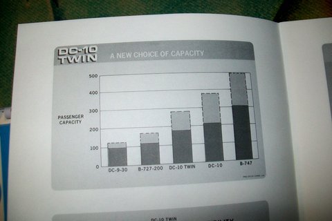

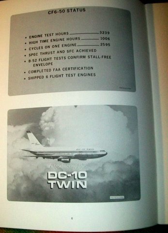

Pics.
