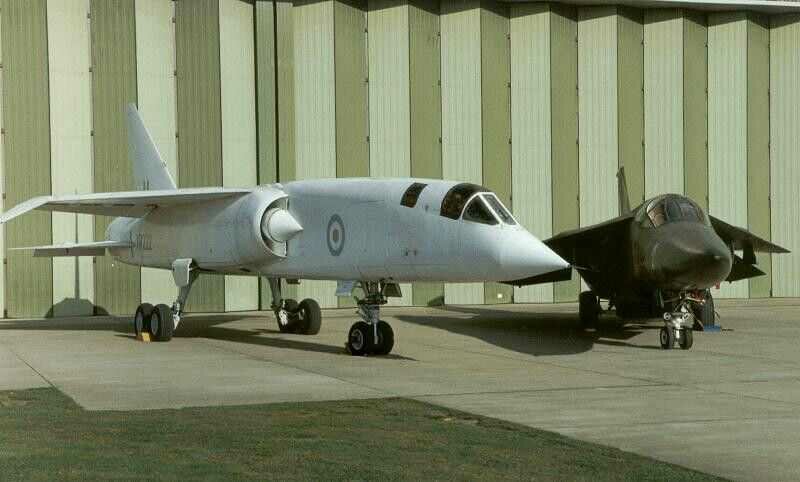

This photograph shows TSR2 and F111 together.
Apart from the obvious size difference the F111 would have been much easier to service.
