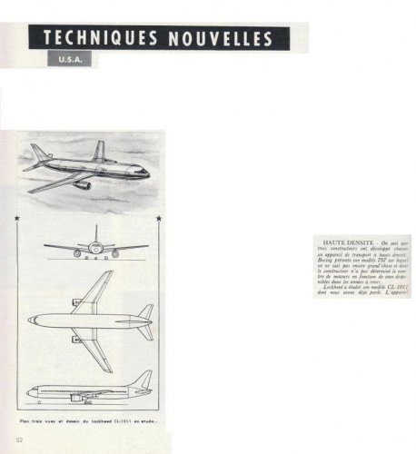

Dear Boys and Girls, here is a small article in French on the original twin-engined Lockheed CL-1011 "Kolk Machine". This design appears to have a wide-body horizontal ovoid fuselage cross-section. It isn't "secret", but it is a "project"......
The article comes from the 1st December 1966 issue of Aviation Magazine International......
Terry (Caravellarella)

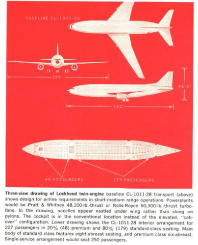

the Lockheed CL-1011-28 was a twin engin design and CL-1011-30,31,32 & 33 were
original Trijet designs.
CLEARANCE: Above Top Secret
May 26, 2006
23,769
816
the CL-1011-28 and CL-1011-31.
