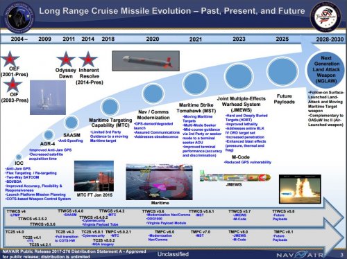

To judge by the comments ("That next-generation weapon could be an upgraded Tomahawk or could be another weapon,”) Tomahawk Block V or equivalent might be the solution here. But after this long with the same basic airframe, it probably does make some sense to look around and see if there are alternatives. Can you get Tomahawk range in a JASSM-based airframe, for example?
