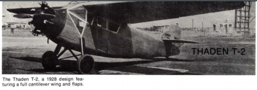

The Thaden Metal Aircraft Company was formed in 1928,and designed light transport
aircraft from T-1 to T-4,the T-3 was a Project,and in Aerofiles,they suggested that
it was developed from T-2 or later modified into T-4,has anyone a more Info or
drawing to it.
Here is a T-2
http://members.eaavintage.org/wp-content/uploads/2013/02/VA-Vol-1-No-9-Aug-1973.pdf
http://www.aerofiles.com/_ta.html
