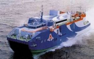

Japan's Techno-Superliner Progressing The development project for the Techno-Superliner (TSL), a high-speed cargo ship expected to play a leading part in high-speed marine transport in the future, has technical targets to have a speed of 50 knots; payload of about 1,000 tons; cruising range of 500 sea miles or more; and seaworthiness enabling it to safely navigate rough seas up to Sea State 6.
This R&D project was launched in FY 89, and the basic aspects of technical R & D work were substantially completed by FY 92. Steady progress has been made, and the Technological Research Association of the Techo-Super liner is confident that the targets will be reached. Two hull types have been developed specifically for the project: a hydrofoil-type hybrid hull (TSL-F), and an air cushion-type hybrid hull (TSL-A).
Sea tests are scheduled to be carried out for data unavailable from tank tests. Two model ships were built, one for each hull type. The TSLF hull type is represented by the model Hayate, and the TSL-A type by the model His ho. The Hayate was built jointly by five Japanese shipbuilders at the Kobe Shipyard of Kawasaki Heavy Industries, and the work to build the Hisho was split between Mitsui Engineering & Shipbuilding and Mitsubishi Heavy Industries.

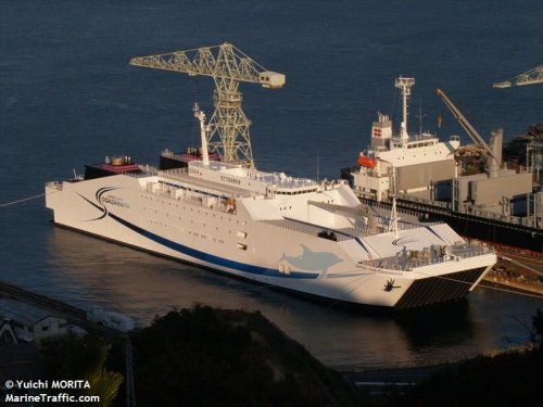

Strange thing though: http://maritime-connector.com/ship/super-liner-ogasawara-9287950/
EDIT: https://www.marinetraffic.com/ro/ais/details/ships/431402027/vessel:SUPER_LINER_OGASAWARA

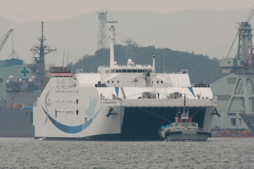

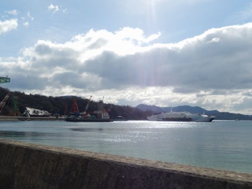

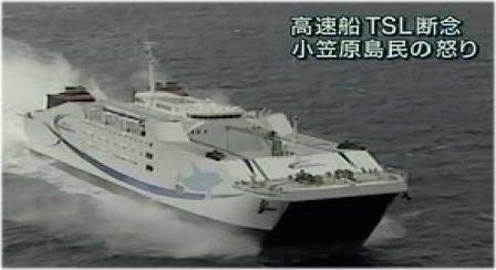

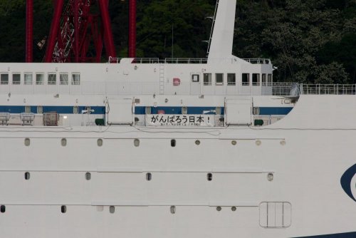

Techno Super Liner Ogasawara visited Iwate Ishinomaki as rescue operations in case of the Great East Japan Earthquake which occurred in 2011.
TSL Ogasawara is moored to Etajima in Hiroshima Prefecture, and is waiting to be dissolved now.

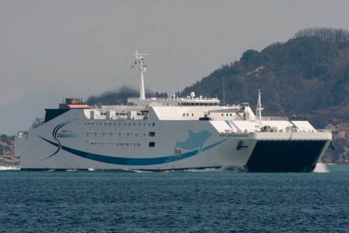

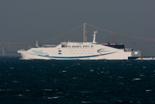

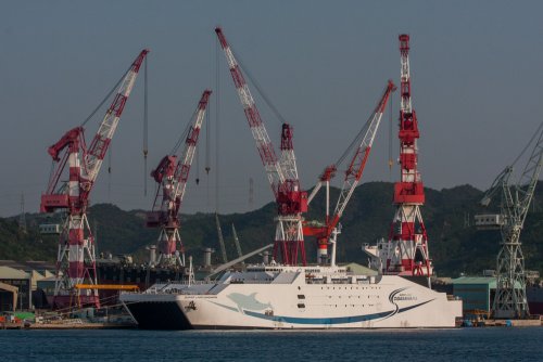

Hi!

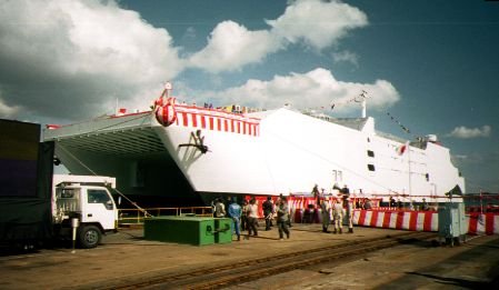

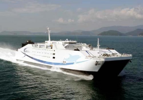

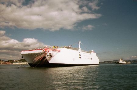

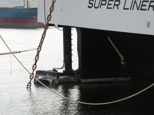

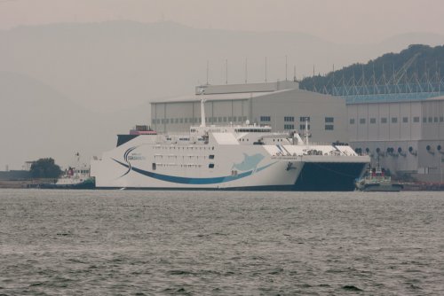

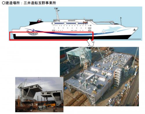

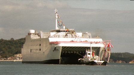

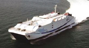

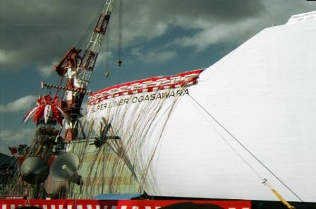

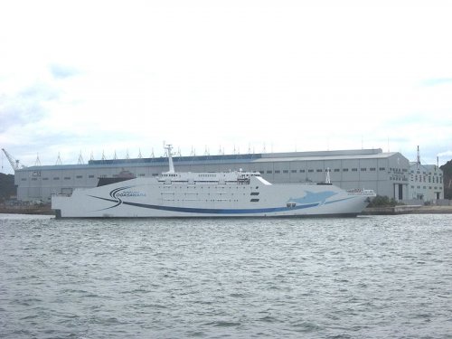

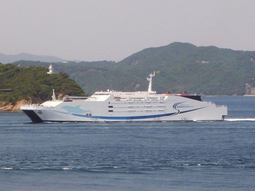

It is a photograph of the launching ceremony of Ogasawara in the Tamano shipyard of Mitsui Engineering & Shipbuilding.
Of course, the fence which prevents the escape of air was added before and after the hull.

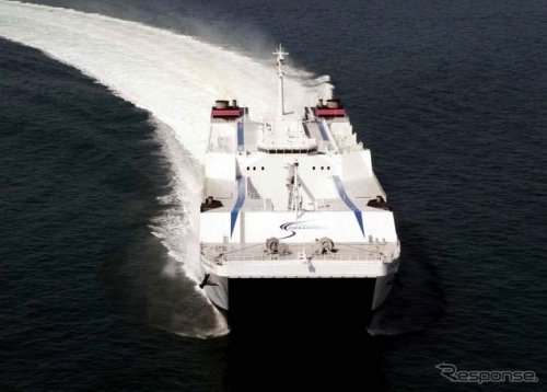

TSL Ogasawara marked 45knots(83km/h) in test cruise.

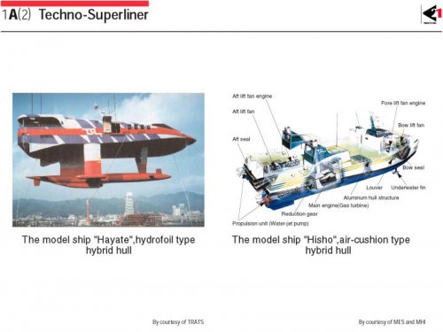

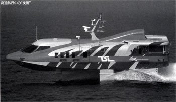

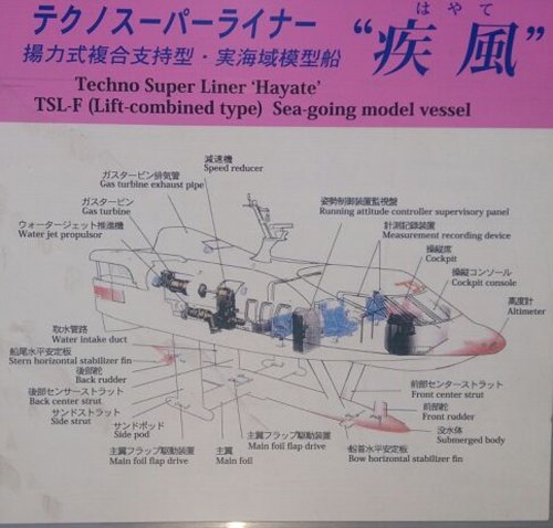

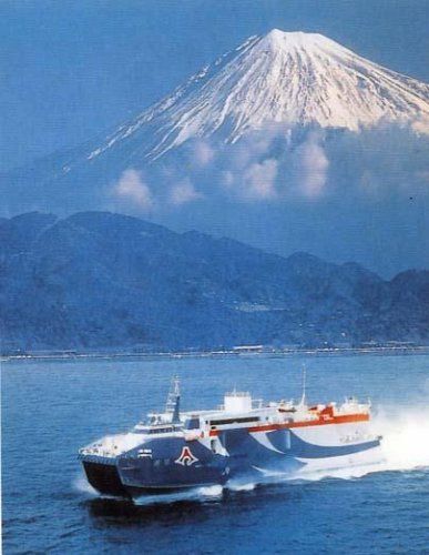

Hi! TSL Hayate(疾風).
http://www.jsme.or.jp/tld/home/topics/no009/Nl95-3-1.pdf

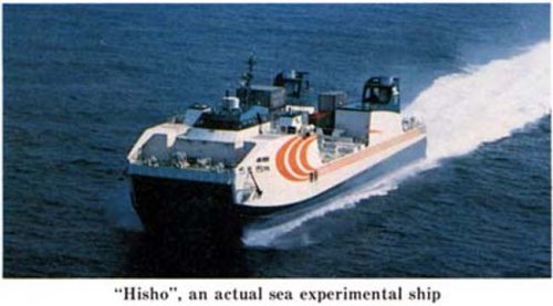

TSL KIBO(希望, HOPE)(HISHO(飛翔, FLIGHT)). Ogasawara and Kibo were same concept ship.

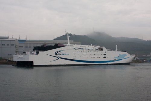

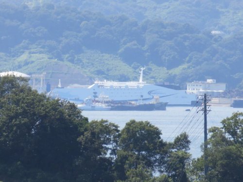

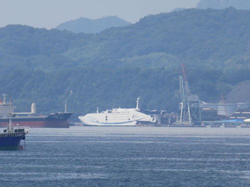

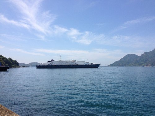

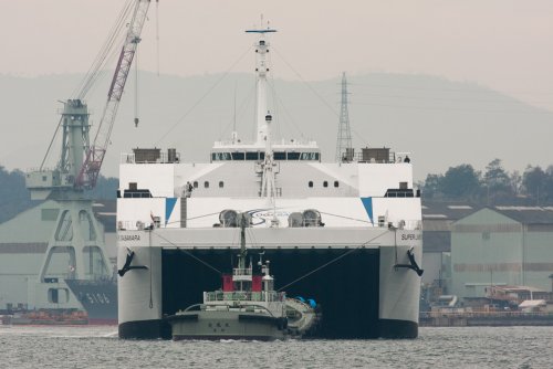

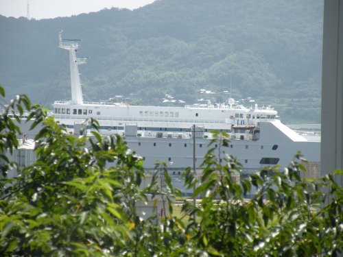

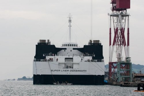

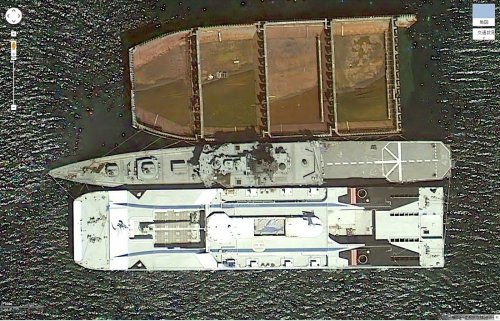

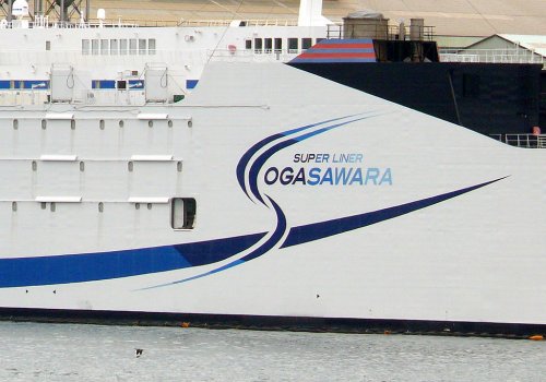

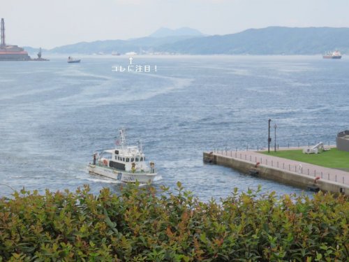

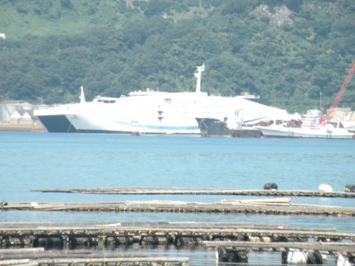

Hi! Ogasawara now 6/9/2014.
When checking with the demolition contractor, there was a reply that demolition of Ogasawara has not been begun yet.

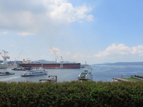

Today I tried to access Ogasawara and failed. Local ferry port in Etajima is too far from Ogasawara. I only watched No.3 picture size Ogasawara ;D
And world heritage Ogasawara islands.

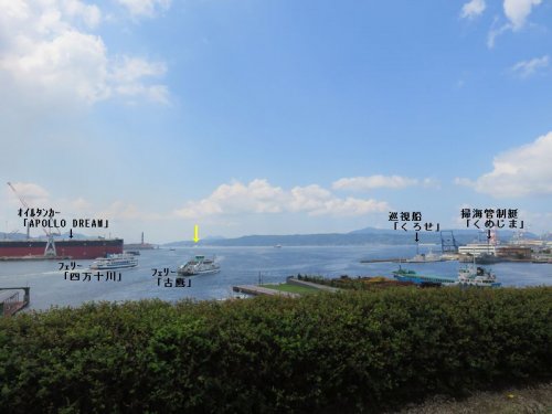

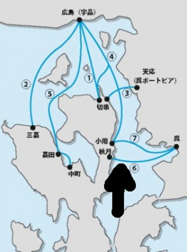

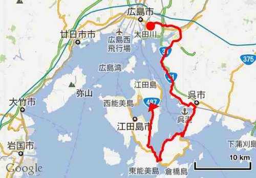

Hi!
広島市 : Hiroshima city,  呉市 : Kure city,  江田島 : Etajima, 岩国市 : Iwakuni city
Hiroshima city : http://en.wikipedia.org/wiki/Hiroshima
Kure city : http://en.wikipedia.org/wiki/Kure,_Hiroshima
Iwakuni city : http://en.wikipedia.org/wiki/Iwakuni,_Yamaguchi
Then in 1952, the base officially became an air station of the United States Marine Corps. MCAS Iwakuni is also shared with the Japanese Maritime Self Defense Force. MCAS Iwakuni has an air station that many people in Iwakuni want to be made into a public international airport. However as of 2009, it is only authorized for military use.
In 2014, it is planned to move the U.S. Carrier Air Wing from Naval Air Facility Atsugi to Iwakuni which will further increase the size of the base.
Etajima : http://en.wikipedia.org/wiki/Etajima,_Hiroshima
http://en.wikipedia.org/wiki/Imperial_Japanese_Naval_Academy
https://www.youtube.com/watch?v=wU2TP9HFh8s
Hiroshima city : https://www.youtube.com/watch?v=ypspRlqoRFQ

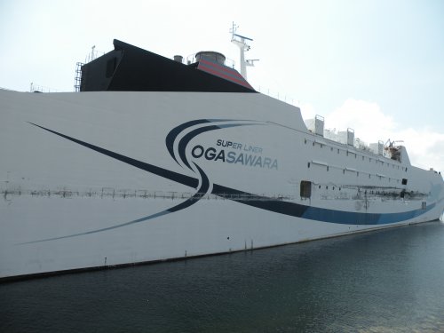

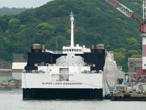

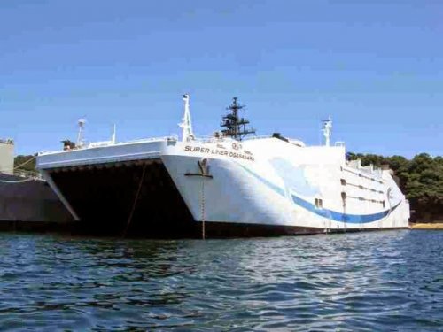

Hi Ogasawara! (7/9/2014)
Next pictures.
This ship was built being put in $130M and completed in 2005 announcing that it can shorten the one-way cruise from 25.5hours to 16.5hours in Tokyo-Ogasawara islands route. It weights 14,500tons, has 140m length, 30m width and accommodation for 742. It is an aluminum ship with the water jet engine. It will be abolished without any operations because of the substantial rise of oil price. 2,400 victims of Great Earthquake in Ishinomaki were invited to use it for free. The aluminum scrap is estimated at $33M.

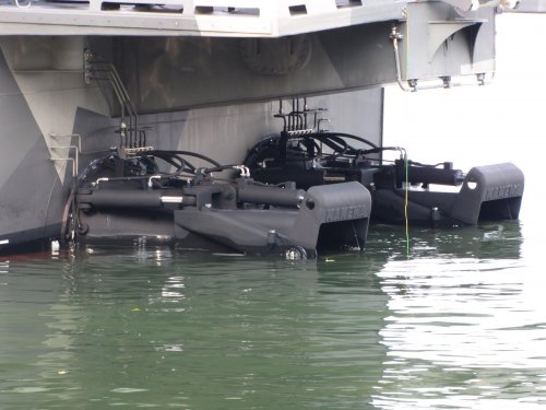

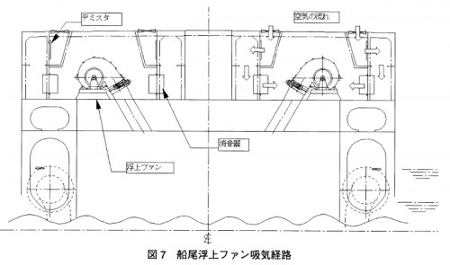

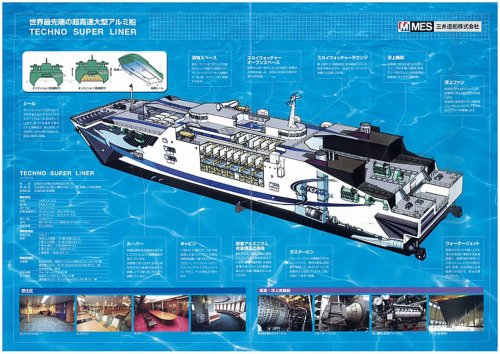

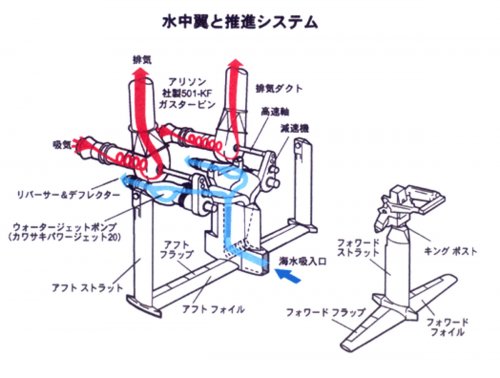

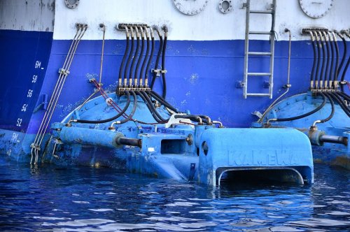

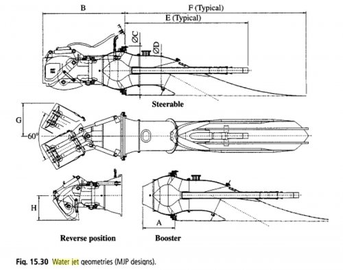

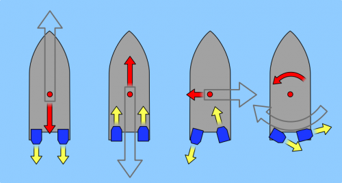

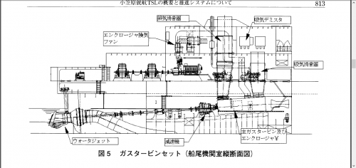

Hi side view and water jet pump!
http://en.wikipedia.org/wiki/Pump-jet
https://www.jstage.jst.go.jp/article/jime2001/39/12/39_12_811/_pdf
主ガスタービンエンジン : Main gas turbine engine, ウォータージェット : Water jet pump, 減速機 : reduction gear.

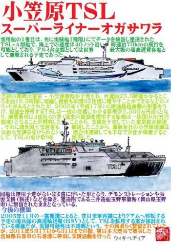

TSL Ogasawara was planned to use as the HSV for U.S. Marine Corps.

Hi! Rolls-Royce Kamewa water jet.
http://www.rolls-royce.com/marine/products/propulsors/waterjets/kamewa_sl/

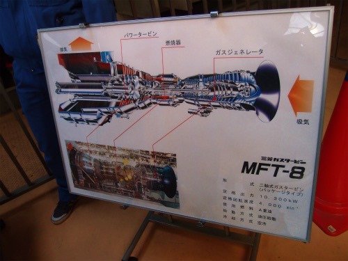

Rapid rise in price of kerosene which is the fuel of a gas turbine engine was fatal to TSL Ogasawara.
Ogasawara's main engine : GE LM2500+(CF6 base), 25,180kw×2.
LM2500+ engine.
http://www.geaviation.com/marine/engines/military/lm2500plus/

Alminum alloy body.
