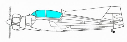

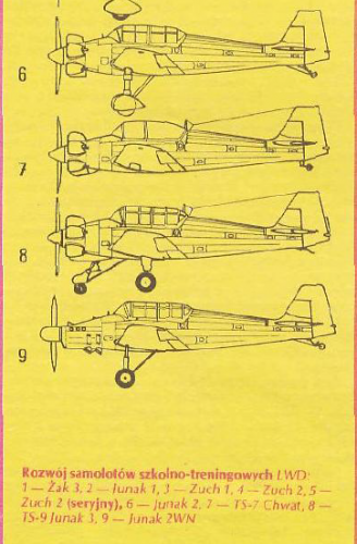

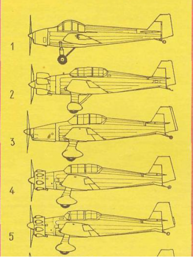

the LWD Szpak-1 was a project of low wing open cockpit side-by-side
two seat trainer aircraft with fixed t/w u/c and 125 hp M-11D radial
engine.

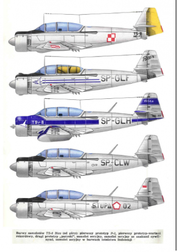

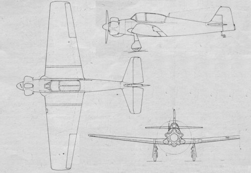

here is in first two views,the way for TS-7,also the TS-9 and the third drawings
is TS-8 variants.
Typy Broni TS-7 & TS-8

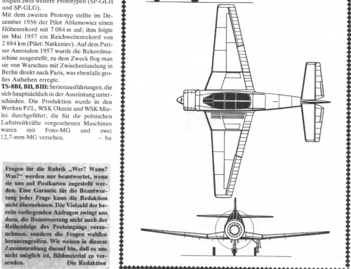

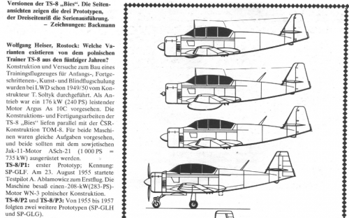

From Flieger Revue 5/1978,
here is anther drawings to TS-8 variants.

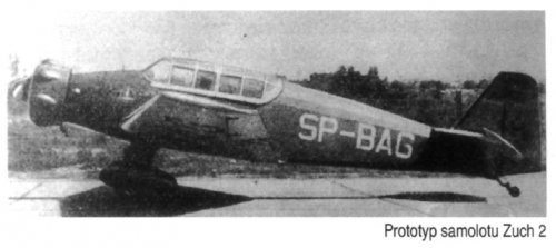

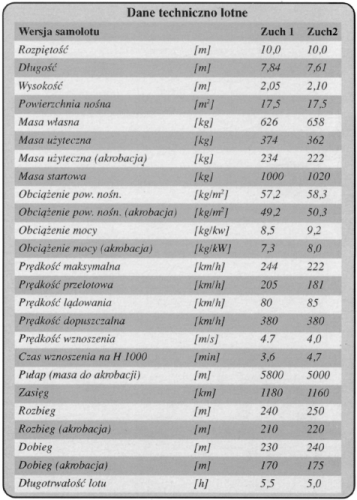

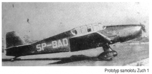

Polish modelling magazine Aeroplan dated 1999-5 had an article about the LWD Zuch variants.
Attached are photos of the Zuch 1 and Zuch 2 prototypes along with details of the two models (in Polish).

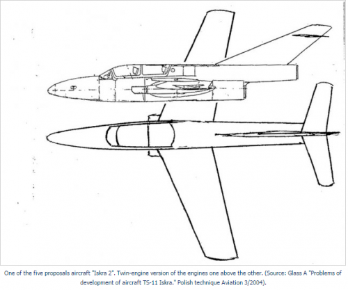

the TS BiesoSum was a project for two seat trainer aircraft of 1956,and TS Iskra 2 was
two seat jet trainer developed from TS-11 Iskra,and powered by two SO-1 arranged as
one above other,looks like English Electric P.1.

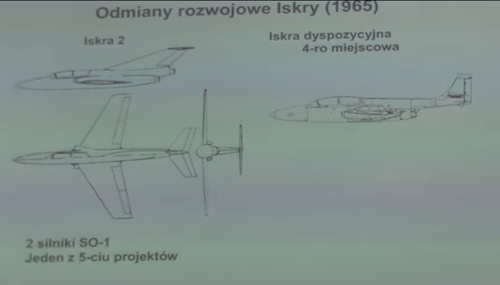

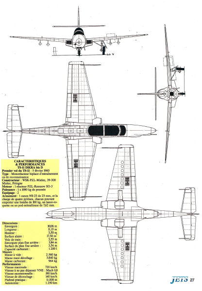

in 1963,Professor Tadeusz Soltyk designed a development of TS.11 Iskra into Iskra 2
or II,appeared in five proposals.
http://www.samolotypolskie.pl/samoloty/2742/126/TS-Iskra-2

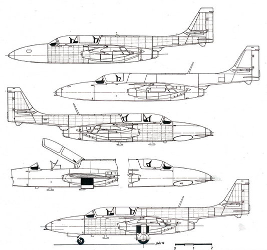

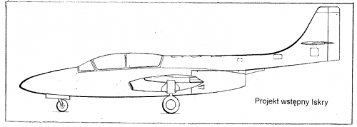

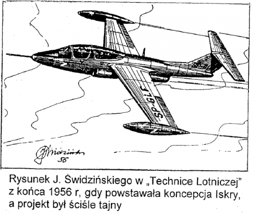

here is the TS-11 Iskra early drawing with T-tail and early profile to it.
http://www.smil.org.pl/ptl/wyklady/03_TS-11_Iskra.pdf

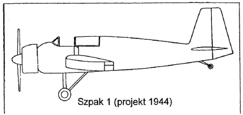

engine.
and here is its drawing.
http://www.smil.org.pl/ptl/wyklady/23_Samoloty_LWD_Szpak_i_Zak.pdf

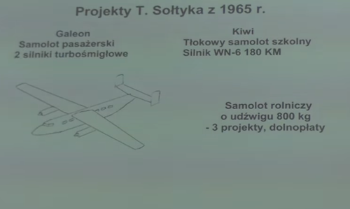

here is one unknown TS Project of 1965.
