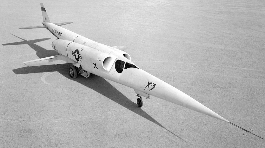

Flying failures:
Blackburn Roc, Messerschmitt Me 210, kalinin K-7, Dornier Do 11, Gloster SS.37, Hawker PV.3, Bristol 123, Vickers 151, Supermarine 224, Westland PV.4, Blackburn F.3, Boulton Paul P.64, Piaggio Pc.7, Handley Page Hereford, Brewster SB2A, Breda Ba 88, Bloch 150, De Havilland DH 91, De Havilland DH 93, Airspeed AS.45, LWS Zubr, Romano R.110, Sharo Lerwick, Blackburn Botha, Silvanskii IS, Avro Manchester, Heinkel He 117, Curtiss SO3C, Caproni Campini N.1, Junkers Ju 322, Blackburn Firebrand, Bristol Buckingham, Bohm und Voss BV 40, Junkers Ju 287, General Aircraft GAL.56, Kokusai Ku-105, Avro Tudor, Leduc O.21, Fairey FD.1........
