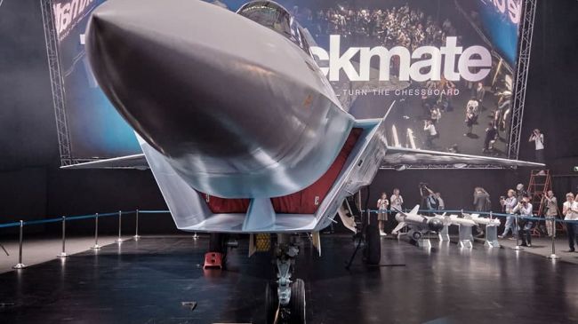

Noticed that on Sukhoi LTS there are no gaps for leading edge flaps to be seen:
Could it be the same as on Okhotnik?
The leading edge flap is clear to see, it is identical to that of the Su-57:
