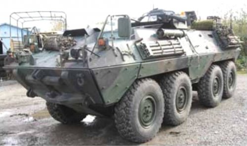

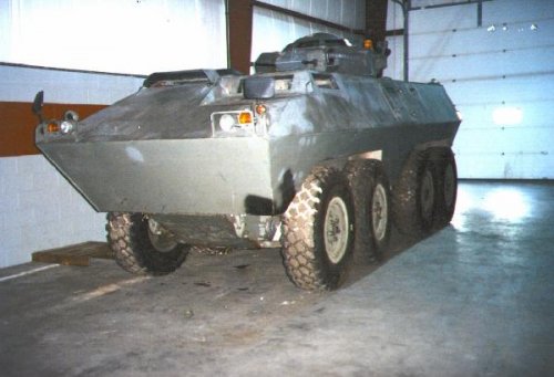

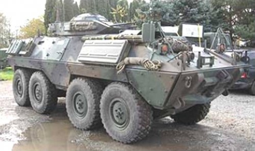

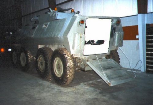

You mean something like this? I can not open the link you give, but form the description, it sound like this.
If my memory are correct, this vehicle is come form Cadillac Gage vehicle family.
Also this vehicle appeared in Resident Evil IV.

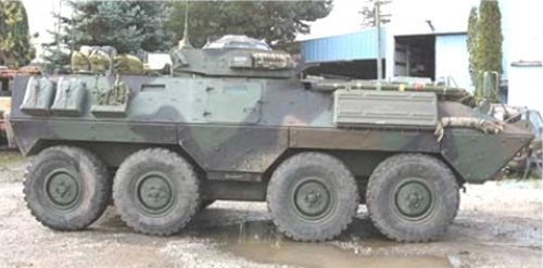

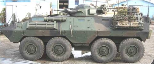

It has been seen in many movies, such as the Incredible Hulk and Resident Evil Afterlife. I have pictures of it in my files labeled as V-150S. The IMCDB site entry lists the manufacturer as Omni International.
Here are two shots of it without the (fake?) applique armor.

Thanks for the info and the shots of it without the applique armour.

The vehicle is very much an engineering prototype and is powered by a GM 6.5 turbo V8 diesel (same as in late 80s-90s Chevy pickup trucks) and an Allison AT-545 commercial vehicle transmission (think school buses, Budget trucks etc.) For the record the front two axles are steering axles much like you see on some larger cement mixers, and the rear sets are fixed. The suspension is longitudinal torsion bar - one each running the whole length of the vehicle - and the suspension itself is wishbone/ double A frame type. You can select 4 or 8 whl drive, though there's provision at each axle to take that axle offline if you pull up the floor plates. Brakes are hydraulic and inboard (inside the hull), with a booster system which again is typically used on hydraulic-brakes school buses and 5 tons. Steering is via standard steering wheel arrangement coupled to a custom designed linkage arrangement driven by a power steering box of the type fitted to larger Mack trucks.
The turret is a modified turret from a USMC LVTP-7, and would typically have a Browning M2 .50 cal on the one side, and a Mk 19 40mm grenade launcher on the other. When we got it, all the electrics had been cut with portions removed, but there was enough left for me to kitbash something in there to get the electric traverse and elevate working again. The turret armour is about 1/2" thick, and the hull armour varies from 1/4" to 1/2" depending on what part of the hull you're looking at. The rear ramp is very mickey-mouse as put together by Omni, and consists of a simple 1/4" ramp door raised and lowered by a light-duty Warn winch and 3/16" aircraft cable. For AVP2 the FX dept. rigged an air ram operated by a dive bottle which quickly raised and lowered the ramp, but that was removed after that production wrapped.
We're looking at several upgrades for the vehicle before the end of the year to include the same Cat 3116 powerplant used in the production LAVs, and air brakes instead of the hydraulic ones. We'd like to engineer a hydraulic ramp to replace the cable-op one too, but that'll probably be in next year's budget.

Looks like the gap between the second and third axles was to allow side, personnel doors ala. BTR.
