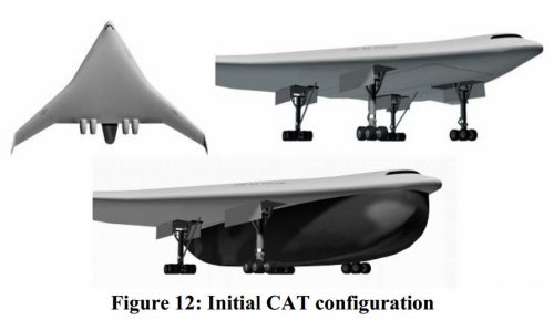

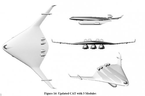

Blended Wing Body Transports: Improved – Aerodynamic performance – Reduced structural weight fraction
Strategic CAT is sized for 5,100 nm escort mission with F-22
Strategic CATs have the range/offload to support global power projection

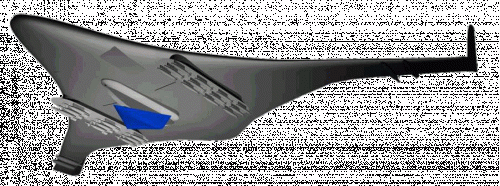

Theater CAT can provide theater air refueling support:
  • Theater CAT (T-CAT) concept could also be BWB configuration.
  • T-CAT has moderately better range/payload than C-130.
  • T-CATs complement S-CATs to complete delivery of modules to forward bases:
  • Regional bases are used to transfermodules to T-CATS.
  • Arriving S-CATs detach modules on ramp
  • T-CATs rapidly pick-up modules and depart for forward bases
  • Theater CAT can deliver modules to 3,000 ft runways

Module-Carrying Tankers
Containerization has swept the commercial shipping world. An entire new architecture of shipping has been implemented world-wide. Modules offer a new approach to efficient cargo transport:
- Preloaded modules can be towed to ramp area for pickup
- When directed, modules move to the active ramp
- Module self-movement minimizes required personnel on active ramp
- Modules are designed to enable rapid cargo loading
- Modules can be raised or lowered to facilitate cargo loading without MHE
- Readied modules are positioned on the active ramp for pickup
- Arriving S-CATs taxi into position to pickup waiting modules
- Loaded CATs quickly depart to establish global-range, high-throughput air bridges
- Modules provide secure storage for arriving supplies & equipment

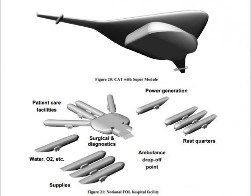

  • General medical evacuation can be done with medevac- configured cargo modules
  • Special medical evacuation can be done with special medevac modules
  • Hospital modules can be used for air-mobile emergency medical facilities
By having the module always available, realistic training and exercises can be undertaken at any time to keep troops fully prepared
The entire module can be decontaminated, if needed.
