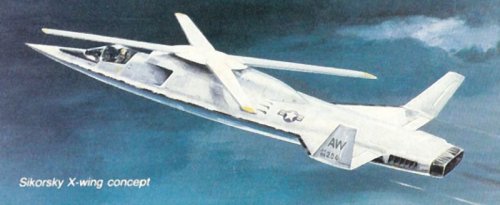

Hi everyone,i was surfing the web today,and came across this strange concept,for a stopped rotor fighter.
page1-1200px-Stopped_Rotor_X-Wing_JSF_Fighter_Aircraft_concept_illustration%2C_May_1999.pdf.jpg
Like a Sikorsky X-Wing but less cool. B)

Wow! 2080 and we are still flying out of BIAP. How depressing. B)
O, Please Dear God, NO!!!!!
I was involved with the non-classified part of the X-wing project.
Most of us in the aero and acoustics sections at Sikorsky spent a lot of time rolling our eyes, because every time we did analysis of the aerodynamics we found something else that didn't work. We were all very glad the RSRA prototype didn't fly; we didn't want the pilots to get killed.

I'd go with 'flawed'... For starters, an aerofoil that has to experience air flow from both directions and be efficient in both cases sounds like 'quite a tall order' ;) Then the location of the pivot to actuate the blades - it needs to be in different positions for different directions of airflow. I could go on...

Flawed concept, mostly because of the controlled circulation airfoils. It was excessively complex and very heavy. In Sikorsky's defense, it was a) a good way to get an unknown amount of "black" project money (projects like this are why many people from the aerospace/defense community think "black project equals wasteful boondoggle."); this was good for the profit margin and b) there were a lot of wacky aircraft/helicopter cross breeding attempts at the time.
