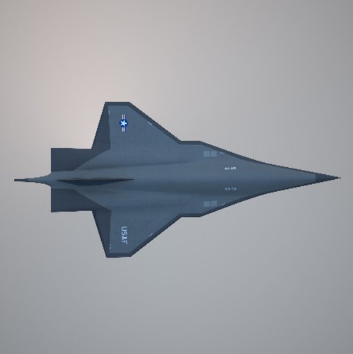

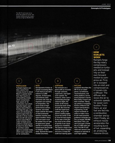

Lockheed Martin SR-72?
Hi! Perhaps better longitudinal propotion.
Fore fuselage is large. Hypersonic area rule?
Vertical tail stabilizer area is very small. It's a CCV?

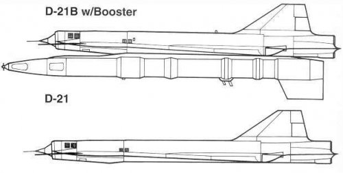

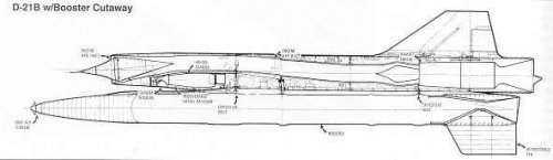

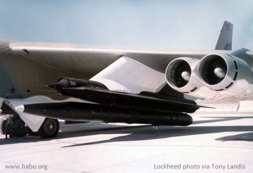

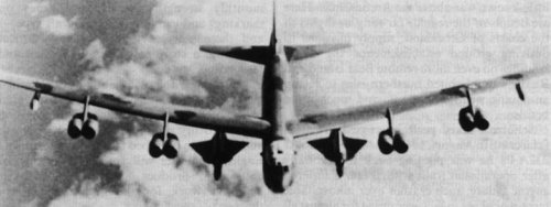

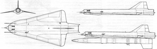

SR-72 is a son of Blackbird.
D-21 was a daughter of Blackbird.
http://en.wikipedia.org/wiki/Lockheed_D-21
https://www.youtube.com/watch?v=GMyC2urCl_4
https://www.youtube.com/watch?v=wHuBsBOF4R8

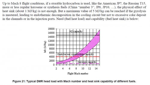

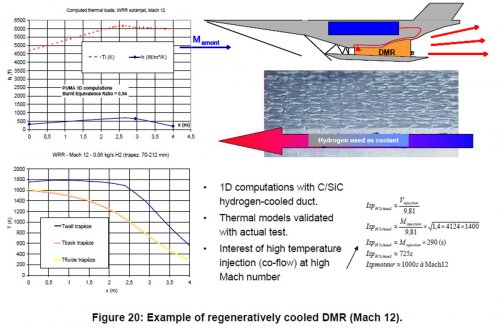

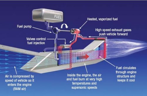

Hi!
Scramjet Thermal Management
http://www.dtic.mil/get-tr-doc/pdf?AD=ADA593050

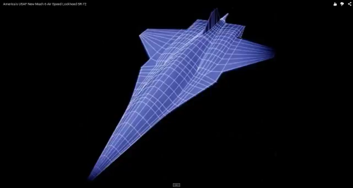

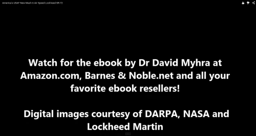

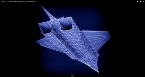

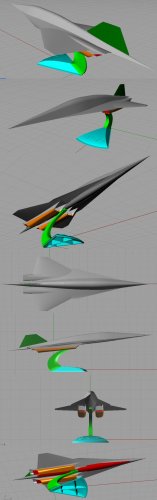

Blackie, please keep on topic.
Of course I do so. ;)

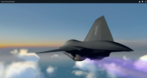

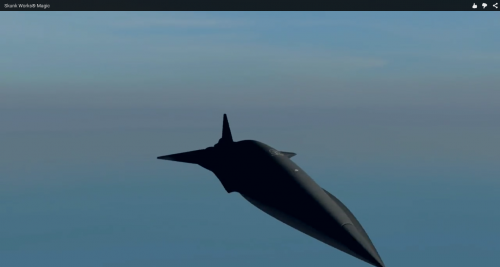

https://www.youtube.com/watch?v=pmeQ0T4VyeU

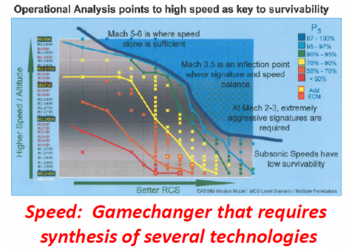

datafuser said:
A slide by Dr. Mark T. Maybury, USAF Chief Scientist, in April this year shows "Mach 5-6 is where speed alone is sufficient" and Mach 3.5 is where both speed and signature equally contribute to survivability. EADSIM model was used to get this result.
do u have the paper? or PPT something? Thanks very much.

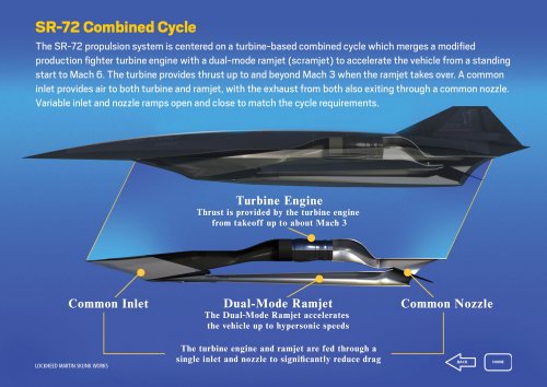

NICE!
it is different from what Pop Science show some days ago,espacially the tail cone。

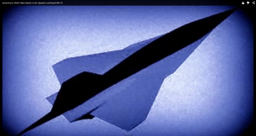

Hi!
https://www.youtube.com/watch?v=Nn7ggx8U5Qg

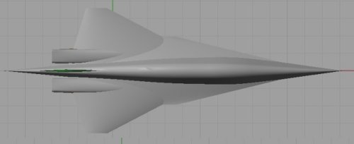

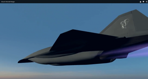

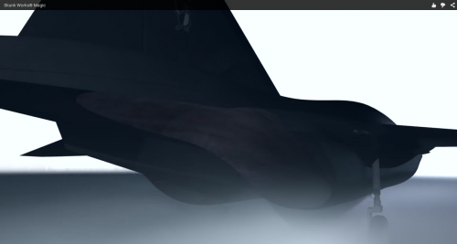

And next video. Enjoy!
SR-72 need very long main landing gear which is installed at the wing.
https://www.youtube.com/watch?v=FnqC9hTMC54

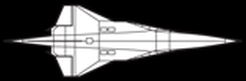

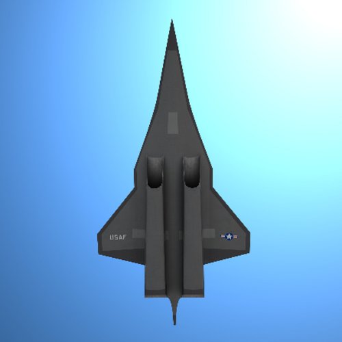

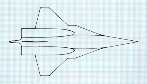

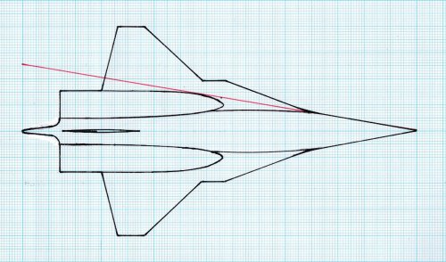

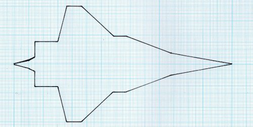

Hi! My image for SR-72 plan outline shape. Tail seems to be short.
The precondition ; Length 30m, Span 16m and attached three pictures are reliable.

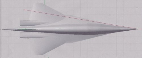

Hi My image for SR-72 plan view and other images.
I see various drawings and think desperately, and being no contradiction, I tried to write a drawing. A drawing which resembles the drawing indicated in the second very much has been completed after all.

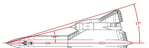

Scott's planform is correct, while yours - not. Do not believe PopSci renders, they are made by artist, not an engineer, and plain wrong in many aspects.
Read something about Mach cone and its relation to airframe OML.
Oh! Anyway thanks a lot. ;)
You mean that span 16m is error?

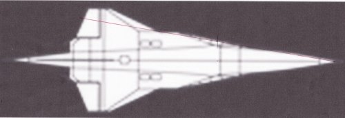

I said it before already. BW planform view is likely of single-engine demonstrator.

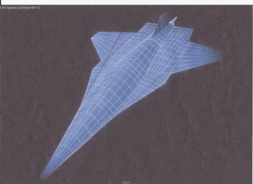

The angle of the Mach wave is determined from:
http://www.secretprojects.co.uk/forum/index.php/topic,1445.15.html
HmHmHm...
arcsin(1/6)=9.594degree.
Hmmm...any way.....

I think if the length of SR-72 is 30.48m(100ft), wing span is 14.02m(46ft),Wing sweep back angle : 81°/72°/50°
I modify my plan view, because I set wing span as 16m at first.
In the long run the last drawing I made has resembled the bottom one. ;D
If the length of the bottom colored drawing is 100ft, wing span is 47ft(14.3256m).
I feel bottom one is good.

If the length of this model is 100ft, the height is 13ft(3.96m).
Doesn't anyone have this model front view?
I think that the main dimention of SR-72 is as follows.
Overall length : 100ft(30.48m)
Wing span : 46~47ft(14.02m~14.33m)
Height : 13ft(3.96m)

Tail of this side view is little short. ;D
Turbine engine is J58?
