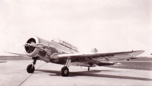

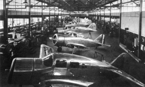

Under the direction of Walter Hurty, chief engineer for Spartan, the prototype was started down the assembly line in early 1937. Factory photos show it partially completed, evidently being built just after S/N 10 Executive, having been given a S/N 8W-1, and identified as NX17612. According to company press releases, the plane would out-perform any single engine military ship then on the market.

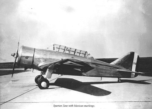

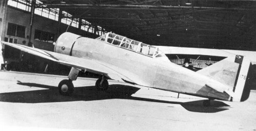

The Spartan Model 8W S/N 1 was the only Zeus ever built. All of the company's plans for tapping the military market with this plane proved to be in vain. The career and ultimate fate of the Zeus is somewhat of a mystery. Early photos, including the factory assembly line photo taken in 1937, show it with Mexican military markings. Spartan was reported at the time to be seeking a large contract with Mexico for this warplane. This would lead to speculation that the plane was actually sold for use in the Spanish civil war, as had some of its earlier Executive cousins. Later, in 1939, it was issued an special experimental license for "One flight from Tulsa, Oklahoma, to Los Angeles & return before 8-24-39".

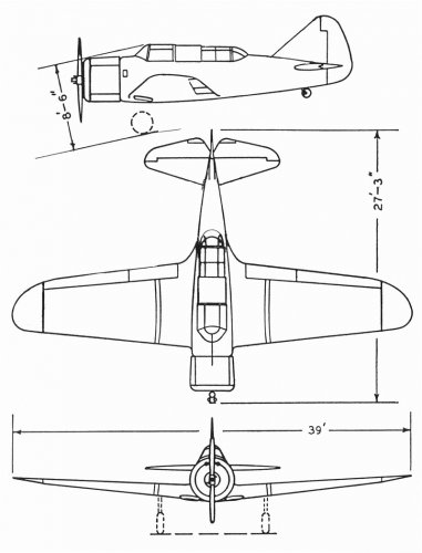

SPECIFICATIONS:
Span: 39 ft.
Length: 27 ft.
Height: 8 ft. 4 in.
Wing Area: 250 sq. ft.
Seats: 2
Power: 550 HP
Fuel: 118 gal
Gross weight: 4500 Ibs.
Empty weight: 3050 Ibs.
Initial R/C: 1650 ft./min.
Range: 680 miles
Cruising speed: 210 mph

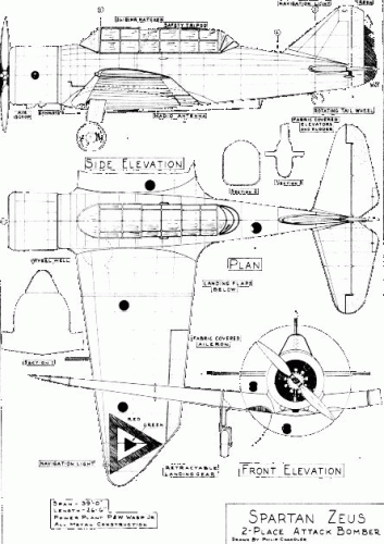

More photos (this time in Mexican guise), two three-view plans, the plane's license, and even a 1939 Shelby Gum card!
