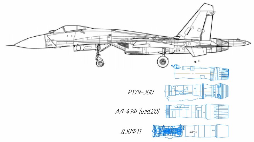

The range of engines based on the R-79 is another class of aircraft. A twin-engine C-37 and a single-engine Su-137 attack aircraft. The Su-27 is too small for him. And even more so D-30F6

Does the afterburner on the D-30F6 have to be that long? Makes me think it's long to keep the CG of the aircraft where it needs to be like the F110-400 on the Tomcat.
As Paralay illustrates, I was under the impression the Al-41 (original) and R79 (or R179-300) were larger, more powerful engines destined to equip whatever the new generation fighter was that followed on from the Su-27, and thus be ready for around the early 1990's.
The thrust, as well as the size similarity, as well as size difference to the Al-31 in Paralays illustration supports this.
