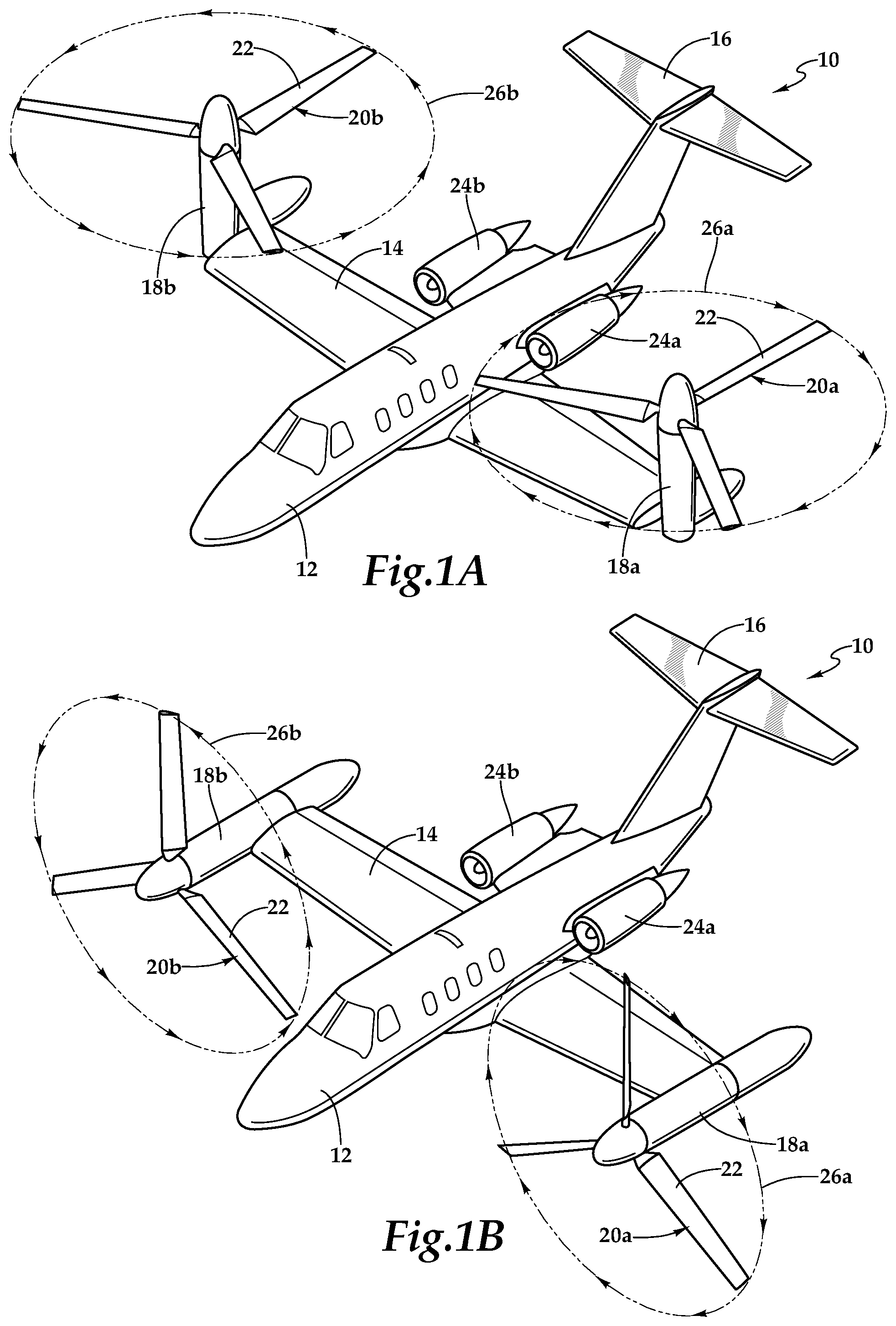

There are numerous patents relating to HSVTOL, the majority of which illustrate a CRJ fuselage with rotors that uses convertible engines. This was most likely done as the patent claims refer to the rotor technology and not the actual aircraft level design, which would be covered by other applications.
The only concept shown that leverages a separate lift and cruise engine set is the small unmanned version, where the weight of an off the shelf dedicated Rolls Royce 250 sized turboshaft (maybe 150 pounds) is probably not going to appreciably affect usable gross weight for its intended missions versus the challenge & cost of designing and integrating a small scale convertible engine.
The (presumably) patent drawing attached in the original post has separate cruise engines and is clearly not a small unmanned machine.
Where are the separate cruise engines in the patent images? The pylons do not contain engines, and are probably shaped for drag and blade fold nesting purposes. The claims are clear there are only 2 engines which are convertible.
FIG. 1A illustrates aircraft 10 in VTOL or helicopter flight mode, in which proprotor assemblies 20 a, 20 b are rotating in a substantially horizontal plane to provide a lifting thrust, such that aircraft 10 flies much like a conventional helicopter. In this configuration, engines 24 a, 24 b are operable in turboshaft mode wherein hot combustion gases in each engine 24 a, 24 b cause rotation of a power turbine coupled to an output shaft that is used to power the drive system coupled to the respective proprotor assemblies 20 a, 20 b. Thus, in this configuration, aircraft 10 is considered to be in a rotary flight mode. FIG. 1B illustrates aircraft 10 in proprotor forward flight mode, in which proprotor assemblies 20 a, 20 b are rotating in a substantially vertical plane to provide a forward thrust enabling wing 14 to provide a lifting force responsive to forward airspeed, such that aircraft 10 flies much like a conventional propeller driven aircraft. In this configuration, engines 24 a, 24 b are operable in the turboshaft mode and aircraft 10 is considered to be in the rotary flight mode.

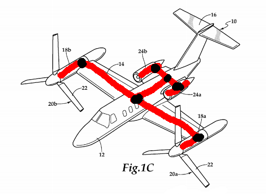

Oh, I get it now. My bad. Rather than four engines, we have half a dozen or more gear boxes scattered around a drive train that would make a spider blanche. Roll on the vibration analysis. I have to say, I actually find the four engines more plausible. But then, what do I know? ;)
Maybe the Citation has always had a VTOL mode? We just didnt know.....
To be fair, V-22/V-280/AW609 all have cross shafting with a mid-wing gearbox in addition to each individual proprotor gearbox for a total of 3.
The manned HSVTOL concepts shown with internal convertible engines would actually have the same number of gearboxes as all existing tiltrotors, just using the MWGB as an input.
3 extra gearboxes, if I am not mistaken (again)View attachment 665217
The patent images showing the Citation airframe are almost certainly placeholders (going back over a decade) for the more practical airframe designs from the very recently released renderings - layout patents that are probably still in the application phase and not yet issued.
Internally mounted engines close to centerline as rendered would have front power take off shafts that could directly feed the MWGB a la F-35B.
I was under the impression that they were exploring electric motors for the prop-rotor phase of flight. So while there would still be some gearing (engine to generator), there would be no gearing to the prop-rotors. Guess I got that wrong.
There has to be a cross-shaft so that in the event of a drive failure on one side, the other can keep both rotors going long enough for an emergency landing.
but if you used electric drive, i.e. a motor in each of the 2 hubs, you wouldn't need a cross drive?
So 2 engines, 2 generators, 2 motors. anything else sounds like your arguing for 4 engines over the ocean........
Even electric motors would need redundancy. There are several schemes available being explored by the UAM world. Joby has double windings and two controllers per motor. But it also has more rotors to share the burden if something fails.
