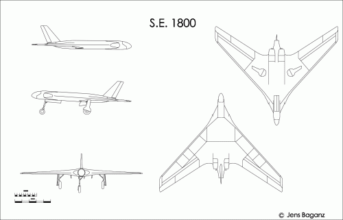

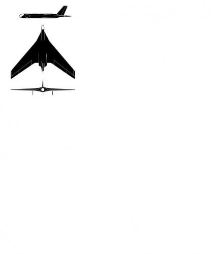

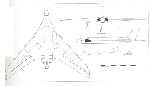

A better, or at least more detailed drawing (that not necessarily means more accurate !) can
be found in Jean Cunys "Les Avions De Combat Francais". I've once used it as basis for a redraw.
A detail shown by Cuny is, that the nose leg is offset slightly to the right side. The concept still
looks rather german to me, something I used as a clue for the landing gear.
Again, just a provisional drawing, without any warranty !

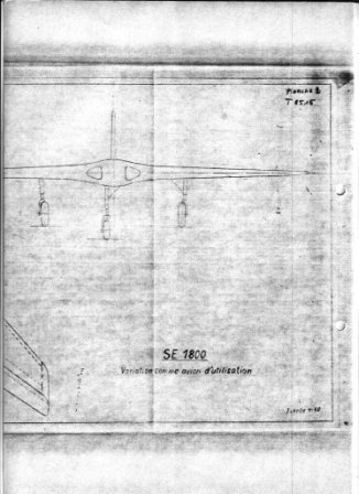

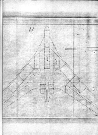

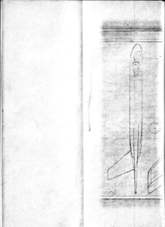

From SNCASE-Marignane design office, doc n° T/8515 dated Feb. the 5th, 1948.
Maybe that was the source for Cunys drawings ? Will have a
closer look and if more details are recognisable, I'll include them.

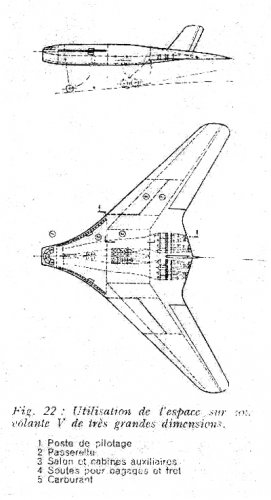

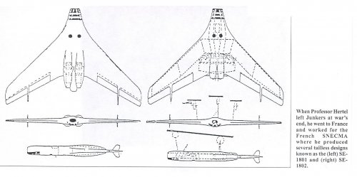

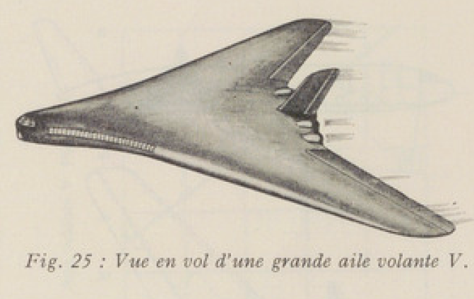

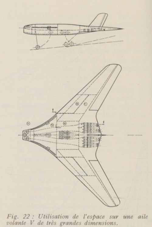

Do you have more information on those SE-1801 and 1802.
They look like scaled-down models of a transport project mentionned in the Interavia issue 8-9, 1950: "Avions commerciaux à grand rayon d'action" by....H. Hertel.

Well, the studies conducted by SNCASE and ATAR were indeed quite similar, but IMHO I don't think they were connected.
The SE-1801/1802 projects seem to be the missing links between Junkers 1945 BWB project (without reference!) and SNCASE?-Hertel project (SNCASE project reference ?) presented in the 1950 interavia issue (i.e. after Hertel left SNCASE).
Please see "Luftwaffe Secret Projects -Strategic bombers 1935 , 1945" by Dieter Herwig and Heinz Rode
Ian Allan 2000.
PP.100 "A Junkers Long Range Project of 1945"

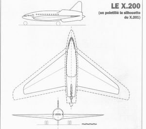

Another SNCASE project came to my mind, especially as the flying wing transport
projects were mentioned : The SNCASE X-200, one of the many pre-projects to
the Caravelle.
(drawing from Le Fana 4.1997)

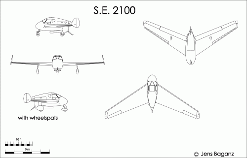

Perhaps the SE-2100, always described as "touring aircraft", was in fact just
built as a flying wing testbed ? ???

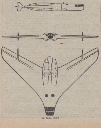

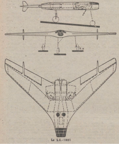

From Ailes 10/11/1956,
here is a drawing to SNCASE SE.1801 & SE.1802,and more info.
