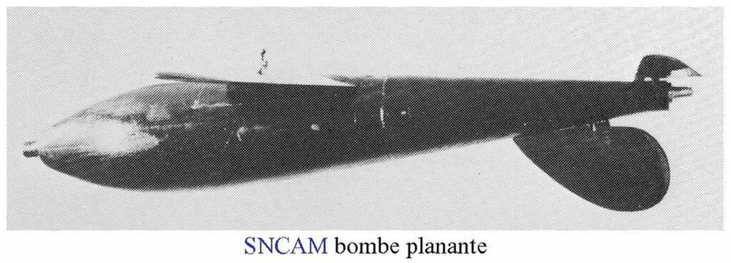

SNCAM glide bomb from 1940, not much information about it.Any new indication would be a good contribution.Thanks

!!! You found the photo?! I only meet a passing mentions of it in Jung and some other sources.
If I recall it correctly, it was basically a glide/guidance kit for standard 50-kg bomb. It was equipped with a wing and a direction rudder, controlled by gyro (presumably just mechanically). It was supposed to be dropped as standoff weapon and follow the drop azimuth toward the target.

Thanks Dilandu, Yes, certainly what you say, it must have been mechanically gyrostabilized because given the weight it is a standard bomb to which is added a directional mechanism for gliding but I'm looking for the moment any consistent document concerning it.

From "The True Beginnings of French Astronautics, 1938-1959 (Part 1)", Philippe Jung, IAC 1999
It should be noted that in the summer of 1939, the SNCAM (Société Nationale de Constructions Aéronautiques du Midi) studied the addition of removable wings on a 50 kg bomb. It no doubt was an answer to the five-year plan of August 1936 that included a highly secret armament section calling for gliding bombs. Heading was kept by a gyroscopic device with barometric drive initiation. Several tests were performed in the wind tunnel of the IMF (Institut de Mécanique des Fluides) in Toulouse Banléve, from October 17 to 19, 1939 and continued in the following months of November and December. After satisfactory trials in Cazaux around March 1940, a pre-series batch was ordered by Armée de l'Air on April 30, a few being delivered from the Bagnères-de-Bigorre prototype plant South of Toulouse, just before the armistice of June 1940 but too late to be used operationally. Modified 100 and 200 kg bombs were also studied as possible guided bombs but they were not built.
