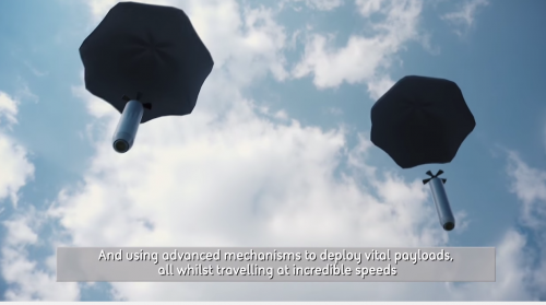

This has been covered upthread, but giving it a bump.
BAE Systems has invested in Reaction Engines and has developed concept of a hypersonic strike aircraft that uses SABRE. The notable thing about the design is that it separates the intake and rocket components and bypasses the problem of the hot plume damaging the sides of the vehicle. It is an aircraft and not a spaceplane - but Reaction Engines is called Reaction Engines and not Skylon Corp because they acknowledge that they don't have the capital to develop a complete spaceplane, but have a propulsion concept that is applicable to a spaceplane among other things. The AFRL also has an interest in the engine for the first stage of a 2STO system.
https://www.digitaltrends.com/cool-tech/bae-funds-sabre-engine-prototype/
https://www.space.com/32115-skylon-space-plane-engines-air-force-vehicle.html?cmpid=514648
http://nextbigfuture.com/2016/07/bae-systems-reveals-vision-of-unmanned.html
https://www.youtube.com/watch?v=XVBHs-aS9WU

First time that I have seen this design, looks like a similar concept to the Skunk Works SR-72.
