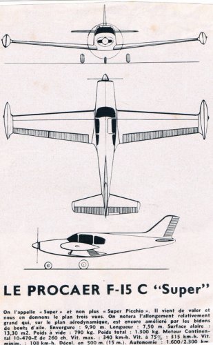

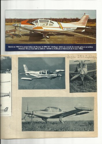

About the "Antilope " : this design was a Procaer (Frati) one : the design was complete and even some metal cut in Italia .
All was sold to S.I.P.A...
Btw , the similarity of the Antilope with other Frati's designs is striking ...
Here , for example , the F-15 C "Super" and an early 3-views of the "Antilope"
Stargazer2006
CLEARANCE: Above Top Secret
Jun 25, 2009
13,240
415
The similarity of any Frati design with any other Frati design is striking.
They all look the same!!! And I don't like them one bit either... ::)

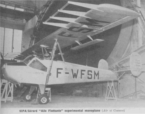

Another SIPA type, although only an experimental aircraft was the
SIPA-GÉRARD "Aile Flottante" from 1960. Based on the NC.853 with a "floating"
wing, following the proposal of André Gérard, it was said to be impossible
to stall.
(Photo originally from Air & Cosmos, shown in JAWA)

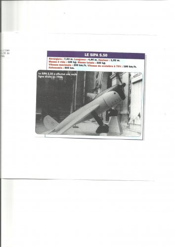

S.50 was a single seat sporting aircraft,powered by one 40 hp Mathis G.2R engine

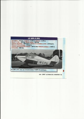

S.90 was a two seat low-wing club trainer aircraft,powered by one 75 hp Mathis G4F engine
S.901 was S.90 fitted with 75 hp Minie 4DC-32 engine
S.902 was S.901 powered by 85 hp Cont. C85-12F engine

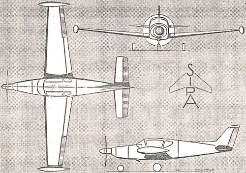

S.200 was mid-wing two seat light sporting jet aircraft

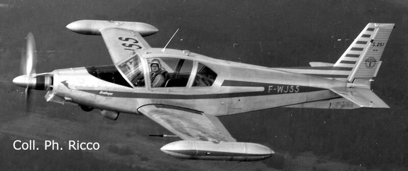

S.2510 (also called S.251) was a 4/5 low-wing light monoplane 665 hp Turbomeca Astazou X
turboprop engines
S.2511 was improved version of S.2510,maybe Project only
