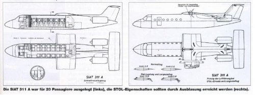

As this theme came up again, I looked my files, finding in FlugWelt 2/1963, what could be an interesting
detail about the Siebel 311 A:
Designed as an aircraft with unprecedented STOL performance, control problems in the slow speed regime
were foreseen and should be solved by the use of puffer jets in the wing tips and bleed air slots just behind
the trailing edge. A programmable flight control system should handle the mixture of aerodynamic control
and puffer jets.l

From Flugzeug Classic 10/2003,
here is the SIAT-311A aircraft and some details of the design.
