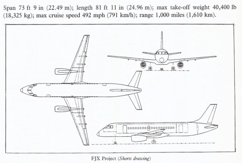

Shorts FJX. Following the success of the Shorts 330 and 360, market research indicated continuing growth in the 20-130 seat category into the 21st century. A decision was made to pursue a twin-turbofan commuter, and design work began in 1986, the FJX being revealed in March 1988. Passenger capacity was to be 44. Dimensions are on the image below, source as above.

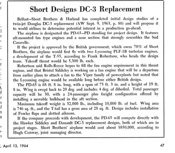

PD.65 specs as of April 1964:
