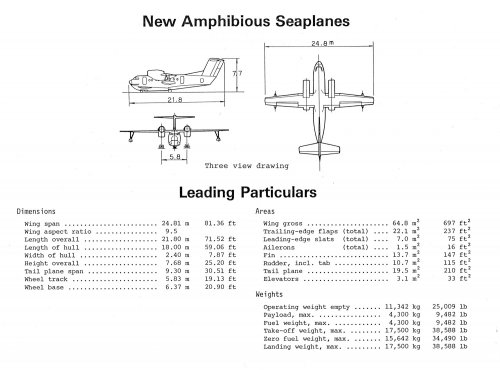

A recent donation of a collection to the Museum included the brochure "Water Based Regional Air Transportation System" which features the Shin Meiwa SS-X. The brochure is a bot too big for the attachment limits so will ask Paul to add it to the thread. In the brochure are the following - a color artwork and the specifications for the SS-X.
Enjoy the Day! Mark
