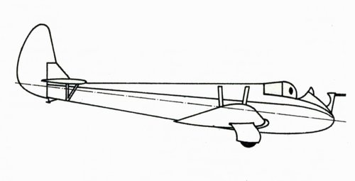

the Shcherbakov SP was a stratospheric glider Project of 1937,span in neighbourhood of 30 m,it was single-
seat GK (pressure cabin) and intended to be towed by high-performance aircraft to max height and the soar
to still-greater altitudes,it was intended to operate height 15 km (49,200 ft).

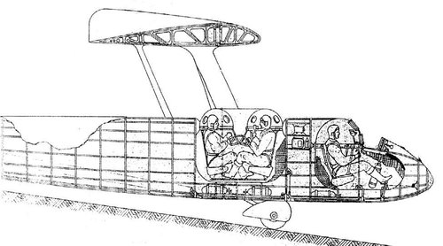

I suspect that this was developed as a result of the in flight refuelling tests carried out in the 1930s with the Gribovski gliders. Shcherybakov who was an engineer with Gribovski, in 1936 had fitted a pressure cabin, to a G-14. This was due to experiments at high-altitude flights in an unpressurized glider cockpit were far from comfortable for pilots. flights, which could greatly facilitate the pilot's work in a rarefied atmosphere. The cockpit consisted of an elastic cocoon made from a rubberized fabric in the shape of the figure of a seated pilot. From above it was sealed with a metal cap with portholes. The pilot dashboard was located outside the cockpit, in the front of the fuselage. It is not known for certain whether the high-altitude" G-14 was a newly built vehicle, or whether it was remade from a production G-14 glider. I have not yet found any pictures of this machine, but who knows it may appear one day!

"... the most outstanding flight was on June 30, 1937, when the R-Z towing aircraft, controlled by test pilot P.E. Loginov, raised the G-9 glider with pilot-glider V.P. Fedorov to the borders of the stratosphere to a height of 12105 m. The pilots were equipped with oxygen masks, dressed in fur overalls. After returning from this flight, pilot V.P. Fedorov said that he could still gain altitude, but that even the smallest efforts spent on the control of the airframe greatly bothered him. The question was raised about creating a pressurized cockpit on a glider. A soft version of such a cabin was installed on the G-14 glider and tested in 1936. It was the first pressurized cabin in the USSR."
