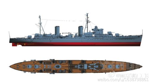

Alright, I've dug a bit up, and had some people translate stuff from from some chinese admirals.
TLDR:
China has no money to pay for soviet salvage ideas and plans
a couple years later, china has the money to possibly pay for it
Soviets recommend a new armament to coordinate with the Pr. 7/7Us they have been given
4x2 130mm B2LM guns + 8x2 57mm, speed would have been down to about 30 knots
(other plans were considered - currently "unpublished soviet sources")
China still doesn't have the money to implement said plans, and eventually decide it is not worth it to repair the cruiser instead of building new destroyers/patrol ships/submarines
Eventually, the ship is refit with the VTE engines out of one of the late 1890s patrol ships, and is used as a floating barrack for oil rig workers, before being scrapped ~~sometime in the 1990s?~~ Sometime during the Cultural Revolution (1966-1976)
