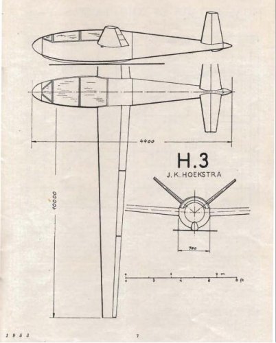

Hi all,
Jan L. Hoekstra built in the 1950´s the sailplane H.3 (attached drawing). I search for the H.1 from 1934 and the H.2 (maybe a project). Can you help?

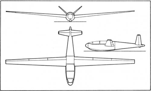

My dear Maveric,
this Netherland designer had been created the H.1,it was a two seat sailplane,after that
appeared the H.2,which was a small aircraft,but no more details,and here is anther 3- view
to H.3.

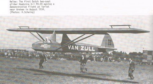

The Hoekstra H-1 two seater appears in the Dutch civil register as PH-24. It had a first fight on 22 July 1934 and was destroyed by gales in 1934 or 1935.
(Source: Dekker, H., Complete Civil Aircraft register, The Netherlands, Air Britain, 1987). This book has a photo of PH-24, which I will scan later today.
There is no reference to the H-2 and H-3 - so does anybody have more information - in particular a time frame
Here is the photo of the Hoekstra H-1. from the Herman Dekker book I mentioned earlier.

I had a reply from Herman Dekker himself. He does not know about a H-2 so he concludes it was never built.
He confirms that the H-3 was a design of a single seat glider with a v-tail. Never built.

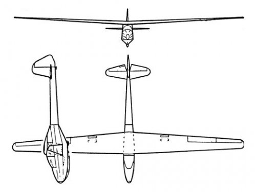

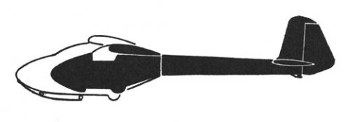

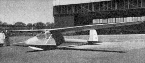

Maveric links to a site that says the Akerboom-Schmidt T-20 was built by J.K. Hoekstra.
Constructeur J. K. Hoekstra, Katwikk, Nethelands 1
Nombre total de constructions 1
Infos techniques Roue fixe et patin.
Histoire résumée Version biplace du T-10, avec sièges en tandem. Peut être employé comme monoplace sans qu'il faille prendre du lest, le second siège se trouvant à la position moyenne du centre de gravité.
'J.K. Hoekstra, Katwikk, Nethelands' would be Jan G. Hoekstra, Katwijk, Netherlands.
It is possible the Akerboom-Schmidt T-20 and Hoekstra T-20 were different aircraft, but is seems more likely they were one and the same aircraft.
Hoekstra's company Hollandair mostly did aircraft repair, modifying aircraft may have been a sideline.
Images from http://www.j2mcl-planeurs.net/dbj2mcl/planeurs-machines/planeurs-docs_0int.php?n=2529
