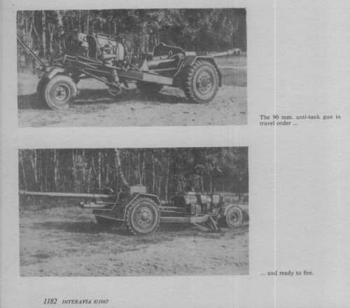

From InterAvia 8/1967:
The gun was intended to use its selfpropulsion unit only for changing position,
as quick as possible, not as a replacement for a towing vehicle. It gave the
gun a max.speed of 12,5 mph and the ability to climb 50%.

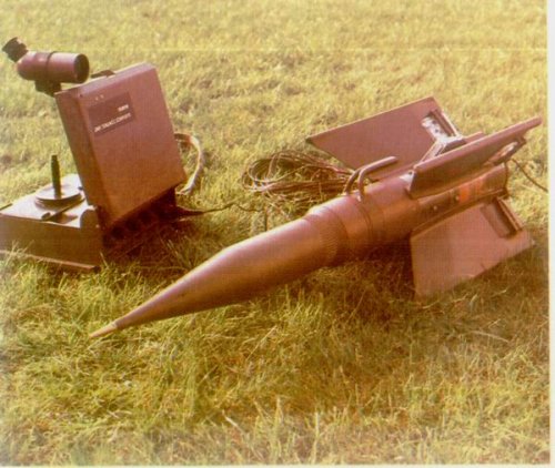

Cobra and Mamba always struck me as an interesting solution to the design of ATGWs. They were fired by placing them on the ground, resting on their fins in the direction of the enemy. A small booster between the lowermost fins was used to launch them, so they literally "jumped up" and then the sustainer motor fired and they flew towards the enemy tank. I believe the Israelis made limited use of them in 1967.
Cobra was excessively slow and thus easily countered with smoke and coax/gun counter-fire despite the ability to launch 60m away from the controller (it had to be steered to a course between controller and target anyway).
Mamba wasn't procured in favor of Milan (which was easier to control, night-capable, able to 'see' through most smoke - but prone to IR countermeasures to some degree and much more prone to counter-fire than Cobra).
The Israelis used SS-11, a popular and larger French contemporary of the Cobra.
The really intriguing thing about Cobra was its small weight - about as much as a Pzf3 only.

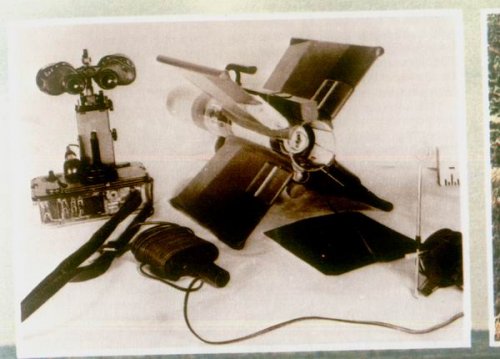

Cobra was indeed a very light ATGM, according to Bill Gunstons "Encyclopedia of Rockets
and Missiles" a soldier could carry two of them. And I remember seeing a film during the
'60s, where soldiers jumped off from a jeep, each carrying two complete missiles. On the
photos below (one shows the very similar Mamba) you can see a very pominent "handle"
on the back of the missiles. I don't know, what is for, but in this film at least it was used
as this way, grabbing the missiles from the still driving jeep !
(Photos from Bill Gunston, "Encyclopedia of Rockets and Missiles")
