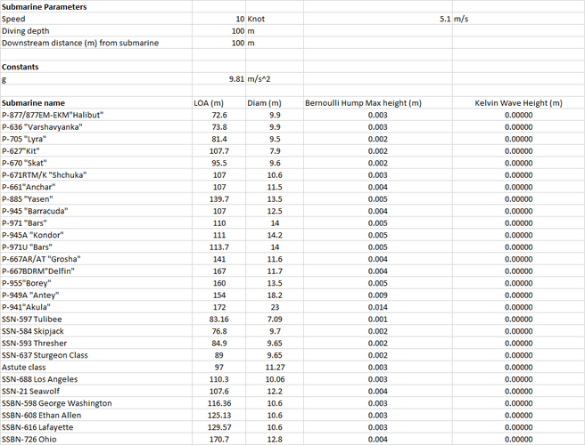

It's an extremely ambitious demand. Reading back on Tom Stefanick's excellent "Strategic anti submarine warfare and naval strategy" One can see what kind of wave height produced by submerged submarine :

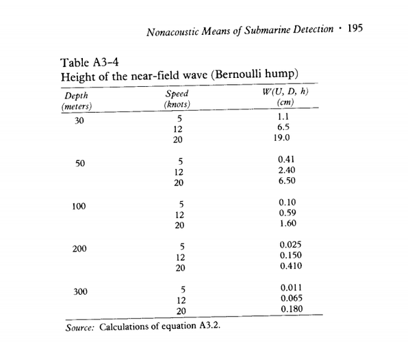

This one is for Near-field

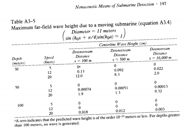

This is the Far-Field wave height.
As one can see the value is extremely small and may not be consistent with typical submarine operation, like. One wont expect for an SSBN in depth of 30 m moving at 20 Knot speed, as this would increase the probability of cavitation, increase of acoustic signature and in area where supertanker could be expected, the submarine could run into risk of collision.

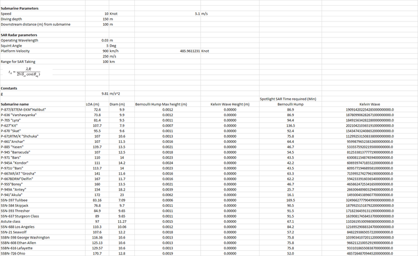

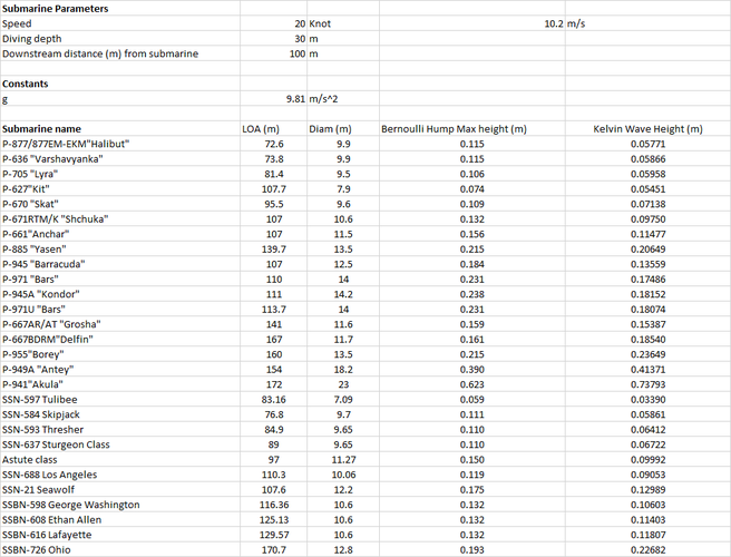

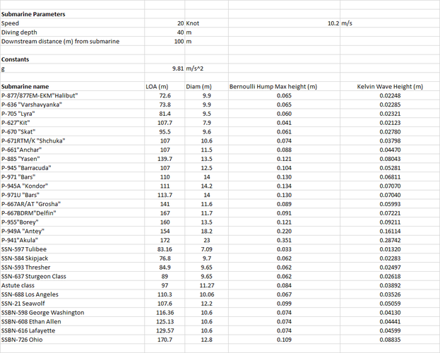

Anyone interested on some of the maths behind these Kelvin and Bernoulli Waves can read this great book by Tom Stefanick.
These are my estimates based on the book, applied on several types of Submarines. As one see in 30 m depth and speed of 20 Knots. The Bernoulli wave are in order of tens of centimeters This wave perhaps detectable by High resolution SAR's. The Kelvin wave however are in smaller order. The biggest offender however is the P-941 Akula or Typhoon class and the Antey (Oscar-II class). Which can have as high as half and near one meter of these waves. It can probably be spotted with the radar. When moving at 20 Knot.
Things however started to improve at just 10 meter additional depth
The height of the wave is essentially halved. Then in Typical Patrol scenario where diving depth would be 100 m and speed of 10 Knots
As you see the wave height would be in order of Milimmetre. Even the massive Taifun would only creates 1 cm high Bernoulli Hump. While for kelvin wave..essentially non existent.
The spreadsheet that I use is available in this post. It contain the theory and the one to estimate single submarine and the other sheet contain the above table. Well feel free to play with it or suggest correction.
  • Kelvin Wave.xlsx

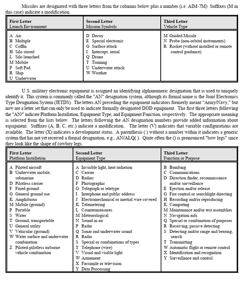

and why LIDAR bears the APS designation ? The P in APS-154 there is radar.
Had it been a LIDAR it would be AAQ, ASQ or AAS or even ASS. As JETDS defines
Excellent point. I commented that it may be LIDAR simply because, with the shorter wavelength and existing academic examples of similar applications, it certainly has the resolution to detect the very small differences in wave height that a deep or slow traveling submarine would produce.
But obviously, that's not actually necessary.

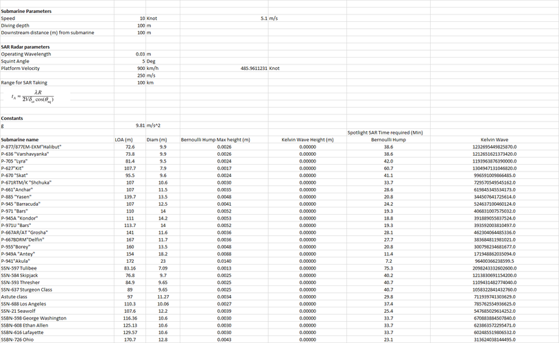

Now if one ask how long it take for Spotlight SAR gathering to resolve the Waves. Using the Spotlight SAR equation presented in Radar Handbook 3rd Edition, and using the generated wave as the resolution requirement. The following can be gleaned.
Squint angle is the angle between the radar and the area being mapped, this assumes 5 Degrees of "forward" looking so the SAR beam is pointed about 5 deg ahead of the aircraft. The range for SAR taking is 100 Km, velocity is 900 Km/h. the SAR is in X-band.
As seen the Bernoulli hump from the submarine at 10 Knot and 100 m diving depth take in average about Half to 1 hour to resolve. While Kelvin wave detection appears to be hopeless. It is however can be questioned that Are this time allowable ? Doesnt that makes the aircraft exposed to enemy radar or ESM's. What if there is more area to search, if there are 10 area and each requires 30 mins. Are those time allowable ?.
Same parameters but the submarine is allowed 150 m depth. The SAR gathering time required to get the necessary resolution increase and nearly triples.
I do heard that while going slow is preferred for stealth, sometime when you need to intercept a carrier batter group, your submarine need to move very quickly. That also why USN prefer nuclear submarine over diesel submarine I think
