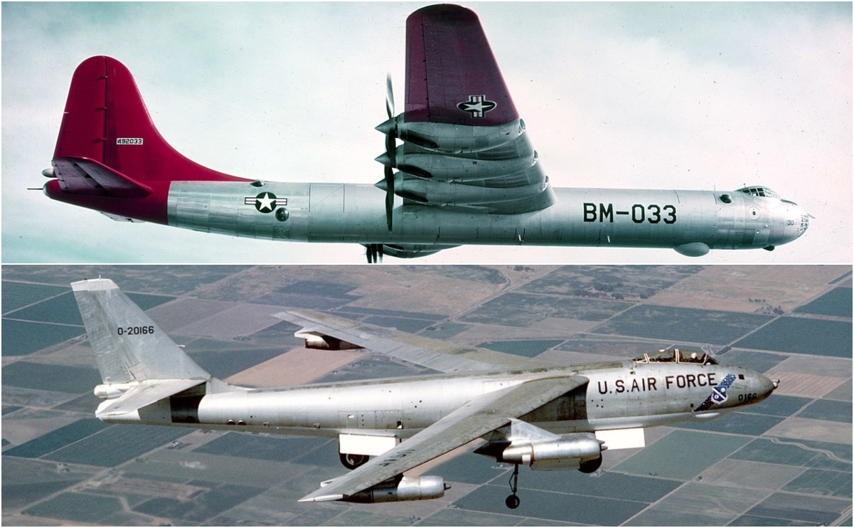

Talking about Project Tom Tom (well more correctly Project Tip-Tow), I just had this come in my feed:
NACA studed concept of a B-36 with a B-47 attached to each wingtip.
(Please note, if this subject already exists, I apologise)
