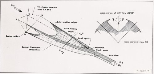

001 - A diagram of a inward turning scramjet inlet module.
The first photo shows the schematic of one module. Point "A" at
the tip is at the tip of the vehicle centerline. Each scramjet
module (of which there are 4) is joined at point "A".
Another important point to look at is the triangular exit of
the inlet module labeled "M3". I will point out these locations
in the photos of the actual inlets.

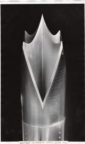

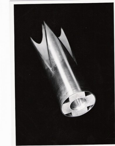

002 - Here is a photo of an actual Martlet II scramjet vehicle
modular inlet. We are looking down at one module. Point "A" of this
module is at the very tip at the top. To the right of the module
we are looking at, you can make out another module turned 90 deg
to the right. Likewise on the left of the module seen in the picture
is another module turned 90 deg to the left. And behind the module
in the photo, turned 180 deg from the module in the photo is yet
another module (you can't see it because it is directly behind the
one in the photo). The point "A"s of each of these modules are joined
at the very tip. So if you looked down at the inlet you'd see
4 modules, each taking 90 degrees of the vehicles circumference.

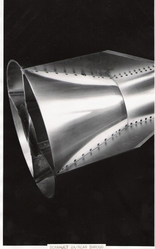

003 - Now we look at the end of the inlet. Remember the triangular exit
labelled "M3"? You can see each of the 4 scramjet modules has a
triangular exit area. Each of these exit areas goes to its own supersonic
cumbustor in the main fuselage of the scramjet attached below this inlet.
In the center are the screw threads which attach the inlet to the fuselage
of the scramjet vehicle. Also this center area is where the fuel tank
of the scramjet vehicle is. It is also the main load carrying member
of the huge G-load of cannon launch 20,000-50,000 G's !!
The fuel used is Triethyl Aluminum (TEA - (C2H5)3 Al). TEA is highly
reactive (ignites with air at room temp. and reacts explosively
with water). Such a fuel is more sure to burn in marginal ignition
conditions. The fuel injectors for each of the four inlet modules are
inside the inlet component of the scramjet vehicle and can't be seen.

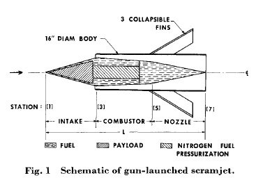

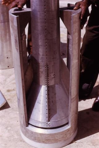

004 - At the end of the scramjet is the nozzle and fin area. As you look
at the end of the actual nozzle, you see the circular area where
the main load carrying fuel tank is. The pusher plate, which attaches
to the end of the scramjet for gun launch pushes against the end of
the fuel tank here when the gun fires.

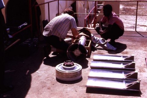

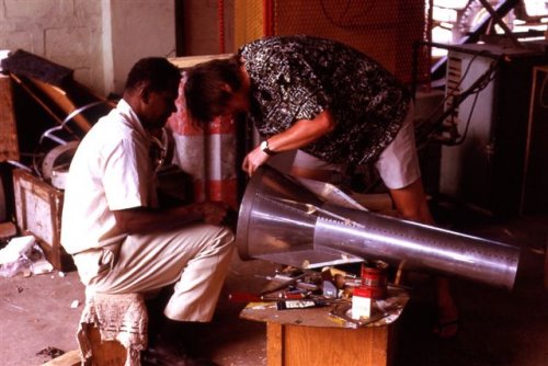

005 - Unpacking a Martlet II scramjet fuselage, fins and nozzle.

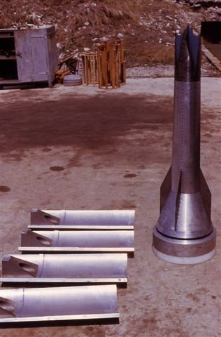

006 - Assembling the scramjet vehicle. The thick round disk is the
pusher plate, which attaches to the end of the scramjet vehicle
and which transmits the load of the gun firing, to the vehicle.
The 4 curved walls to the right of the pusher plate
are the pieces of the sabot which will surround the scramjet
vehicle when the scramjet is loaded into the guns breach. When
the scramjet flies out of the end of the gun, the sabot is
supposed to blow off the scramjet vehicle. The sabot is used to
provide a seal to trap propellant gases behind the vehicle, and
to keep the vehicle centered in the barrel.

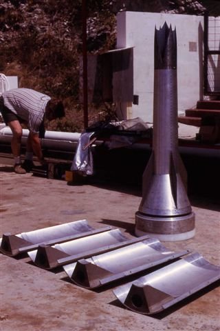

007 - Assembled Martlet II scramjet vehicle with pusher plate
attached at the bottom, and inlet attached at the top. The 4
sabot pieces are lined up along side.

009 - This how the sabot attaches to the scramjet vehicle.
When all 4 sides of the sabot are in place, the bottom
half or so of the vehicle is completely surrounded
by the sabot.

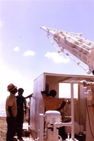

010 - Loading the scramjet into the gun breach.

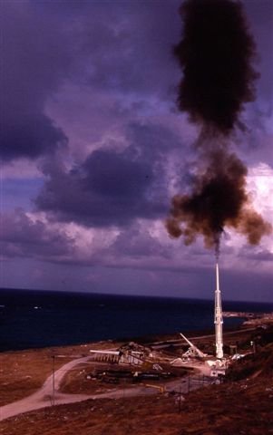

011 - Gun being raised into position - to 85 degrees.
012 - Gun fires. Muzzle velocity - Mach 5.5 at sea level ! Scramjet inlet
must work at Mach 5.5 at sea level, including compensation for
boundary layer. These inlets worked well due to a lot of tunnel
time in a gun tunnel back in Canada where the performance was
measured.

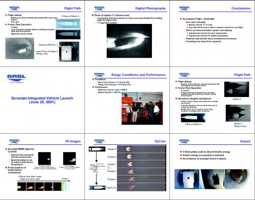

Not HAARP related but seemed relevant. Scramjet powered round from ATK's site some time ago. Scramfire apparently.
http://www.nationaldefensemagazine.org/archive/2003/August/Pages/Army_Tests3793.aspx
http://www.sse.gr/NATO/EreunaKaiTexnologiaNATO/37.Educational_notes_and_meeting_proceedings_published_in_2007/RTO-EN-AVT-150/RTO-EN-AVT-150/EN-AVT-150%20Presentations/EN-AVT-150-10-PPT.pdf
For the write up on that second presentation see, http://ftp.rta.nato.int/public//PubFullText/RTO/EN/RTO-EN-AVT-150///EN-AVT-150-10.pdf
Thanks sferrin !
Both are interesting to me.
GASL is Tony Ferri's old Lab.
Did you read about Gruen Labs in the recent Super Hustler piece from Code One Magazine?
Same place !
They have a lot of neat scramjet research equipment there.
Thanks sferrin !
I wonder if there is a cheaper way to do it.
FWIW, GASL had been bought and sold many times. The last big propulsion related company to own them before ATK was Aerojet. The problem as a business is the waves of funding related to hypersonics. Very tough from a business sense during the down times. ATK has actually been laying off folks on LI and in FL over the past year or so, iirc. The original complex was in Westbury, NY, now in Ronkonkoma. There has been a long funding relationship with the Hypersonic Propulsion Branch at NASA LaRC and a fair bit of the equipment is GFE, such as HyPulse. LegV/FAST was funded by MSFC under ARTT/ART in NGLT. Initial Mach 4 tests of the LaRC 3-strut scramjet http://hapb-www.larc.nasa.gov/Public/Engines/3-strut/3-strut.html were done in the Westbury combustion heated facility as documented in, Initial Wind Tunnel Tests at Mach 4 and 7 of a Hydrogen-Burning, Airframe-Integrated Scramjet, Guy, R. W. and Mackley, E. A., AIAA 79-7045, 4th International Symposium on Air Breathing Engines, April 1-6, 1979, Orlando, FL. http://hapb-www.larc.nasa.gov/Public/Documents/AIAA-1979-7045.pdf

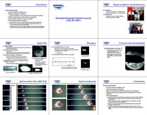

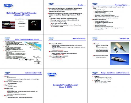

Some additional info:

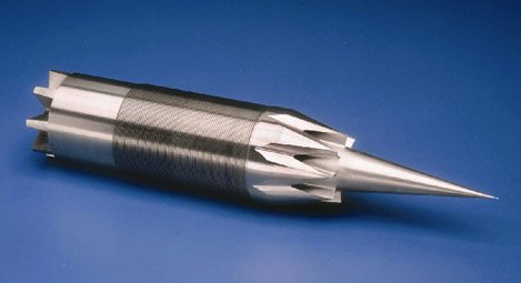

What a beauty! I have never seen such a beautiful artillery projectile like this before. A treasure that deserved to be preserved.
