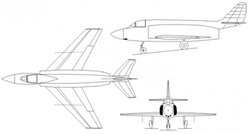

D.730 & D.740
In 1953 Emile Dewoitine presented to El Ministerio del Aire two related projects of jet fighter: a straight-wing D.730 and a swept-wing D.740. Both used the Rolls-Royce Nene jet-engine of 5000 lb/2270 kp thrust built in France under licence by Hispano-Suiza or originally built in the UK. Also both projects shared nearly identical fuselage.
D.730
Length: 9.60 m
Wingspan: 10 m
Wing area: 16 sq.m
Aspect ratio: 6.25
Height: 3 m
Empty weight: 1970 kg
All-up weight: 4024 kg
Max. speed @ SL: 910 kph
Max. speed @ 4500 m: 900 kph
Max. speed @ 9000 m: 860 kph
Time to 4500 m: 3' 8''
Time to 9000 m: 8''
Ceiling: 140000 m
Range @ 4500 m: 800 km
Range @ 9000 m: 1058 km
Range with drop tanks @ 4500 m: 1550 km
Range with drop tanks @ 9000 m: 2100 km
D.740
Length: 9.60 m
Wingspan: 9.25 m
Wing sweep angle: 36 deg 30'
Wingspan: 16 sq.m
Height: 3 m
There is no available information either on D.740's estimated performance or on planned armamament for both projects.
The Ministerio del Aire did not take both project into consideration. My presumption is the RR Nene was not available to the Spanish and, pehaps more importantly, in 1953 having just signed a treaty with the US Spain had secured deliveries of quite modern aircraft, in the form of the F-86, so starting works on an indigenous fighter was quite rightfully deemed unnecessary.

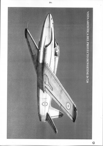

This one? Sorry for off topic.
https://www.aviationsmilitaires.net/v2/base/view/Model/1966.html

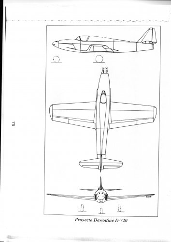

D.720 : 1948 : interceptor jet (project studied in Argentina)
Yes.
https://www.secretprojects.co.uk/forum/index.php/topic,10107.msg94492.html#msg94492
https://forum.aviationsmilitaires.net/viewtopic.php?f=34&t=5313&p=151045&hilit=Deltafan+Dewoitine#p151045
