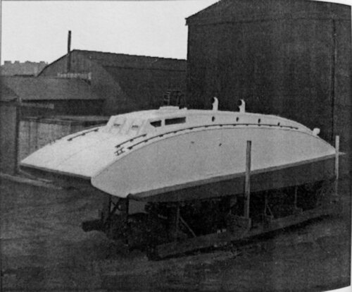

For an article on Marine Aircraft Experimental Establishment for Helensburgh Heritage Trust. Secret trials were held on Loch Lomond of an experimental mtb made by Pemberton Billing. Unable to find info other than the attached. Pemberton Billing had links with Hubert Scott Paine, Supermarine Aviation Works but suspect the hull was made by Morris Furniture, Glasgow, as it worked on projects with MAEE. Has anyone more info on this MTB, tested for the RAF? pemberton.JPG

All links between P-B and Scott-Paine were severed in 1916, so I would discount any connection with this project.
See patent GB498214
P-B commenced experiments with a motor launch, called Multichine, based on his patent and built in Glasgow at a cost of £62000, in 1938 and attempted to interest the military. The RAF did test it at Felixstowe as a potential rescue craft but took the matter no further.
P-B bought it back from the Admiralty in 1946 and named it Commodore.
Like all of P-B's projects it was not half as good as he believed it to be
Maybe this P-B was tested again in 1944/45 with new engines when MAEE was in Scotland. Thanks for the feedback.
Actually I miss-read the article. Commodore was a completely different boat.
I think Multichine was long gone by 1946, and even if not there does not seem to be any reason why it would still have been worth testing.
From Twentieth Century Maverick - Barbara Stoney

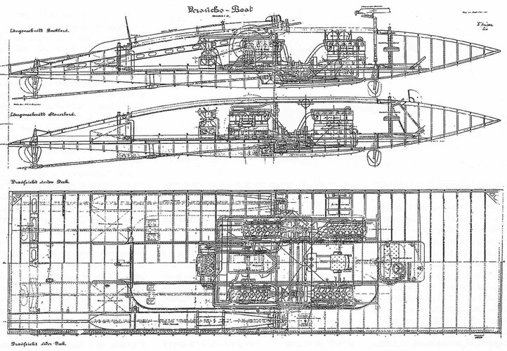

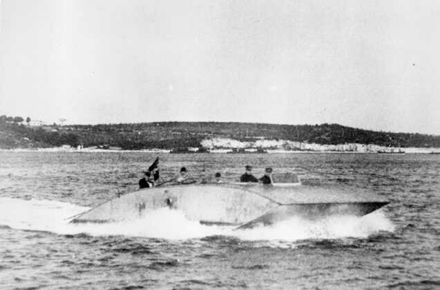

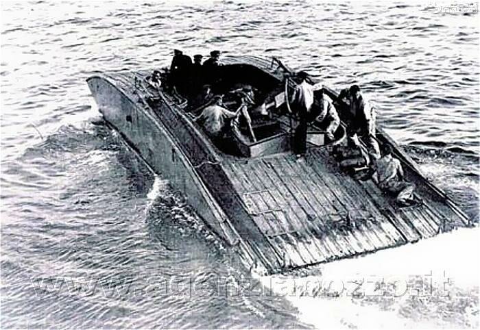

It looks rather similar to the WW1 Austro-Hungarian Versuchsglietboot air-cushion MTB.

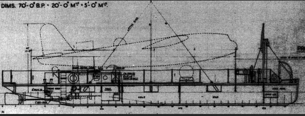

Thanks again for the feedback my PMMTB was obviously a one off secret naval project. My research into the Marine Aircraft Experimental Establishment has led to several experiments with vessels, aircraft and airborne warfare during WW2. MAEE worked closely with MAEE on Blackburn Botha ditching trials. Blackburn, Dumbarton, had no airfield, so in 1938 built a one off barge, the Dumbrough, to transport Botha aircraft to locations. This was a'secret naval project' and no photographs exist that I know of. | dumboro.JPG id manage to find a sketch of Dumbrough

So which one is pictured here? Multichine?
Dave G
Dumbrough, the Blackburn Aircraft barge, which was an add to my original post and nothing to do with PB. Sorry for any confusion
