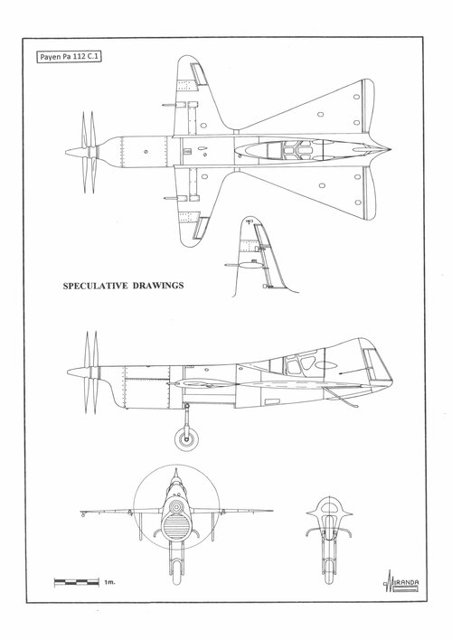

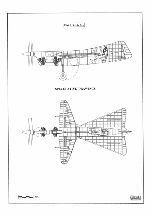

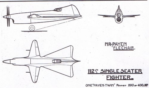

HI all .... I hope you guys have your "thinking caps" on. I ran across this France's Mystery Fighter called the PA-112-C.I. "Flechair". I found s few assorted drawings and renderings. Some show it as a contra-rotating prop while others show it as a conventional single prop. The plane is very odd (to be sure)I am giving consideration to building this as a contra-rotating r/c electric model. Does anyone have some detailed plans of this plane as an r/c model? I have the 3-views and other static model pics along with artist renderings. However with a plane this unusual, it presents many design questions. Any help would be most appreciated!!

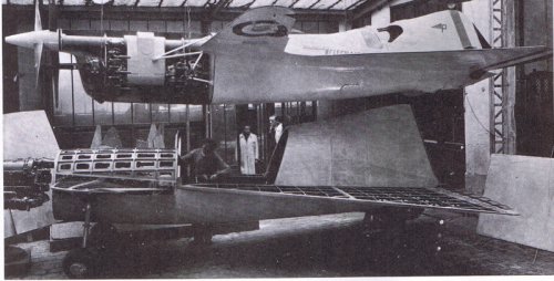

According to AirEnthusiast March 1997 and other sources, the Pa.112 was developed
as a kind of fighter derivative of the Pa.100 and was to be powered by two small radials
in tandem configuration driving a contra prop. Landing gear was a single central wheel and
probably outriggers/skids on the delta wingtips. I've attached a photo of the mock-up,
showing the contra prop quite clearly. Here the heavily framed canopy is missing.

Most of those Payen designs were 'wild', to say the least.
I suppose the nearest equivalent was the infamous GeeBee racer, with its limited visibility, dubious stability, designed for an over-sized engine plus a pilot with an excess of, uh, elan...
How his late-30s designs would have fared against Stukas and ME 109s is moot. Whether he could have got adequate engines --Hence the paired with contra-prop ??-- is another matter...

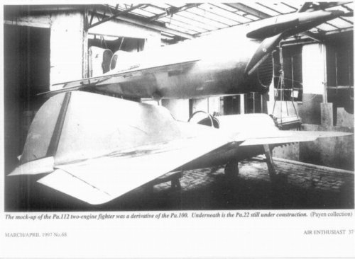

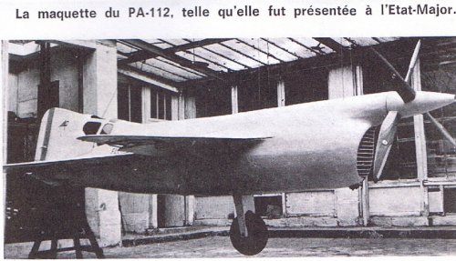

From " l'album du fanatique de l'aviation Nr.5 "
Span 4,2m,length 6,74m,L.W 610kg,max speed 580km/h .
The mockup is the crashed ex PA-100 ,under is the second PA-100.

A clipping from Aeroplane Monthly (May 1993) about the Payen Type 112C Flechair attached.

Yes, it's the 1/1 model of the Pa.112-C.1 from 1938-39
with the 2 x 100hp Salmson AD-9 engines and the Baudot contra-rotating propellers system that never worked good... :(
