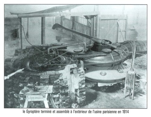

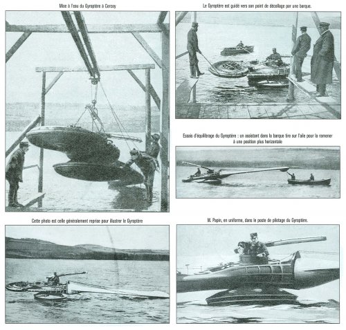

But when Messrs. Papin & Rouilly designed and built their first gyropter, the "Chrysalide", it was... something else!

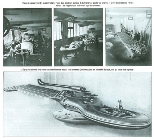

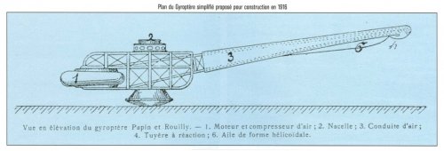

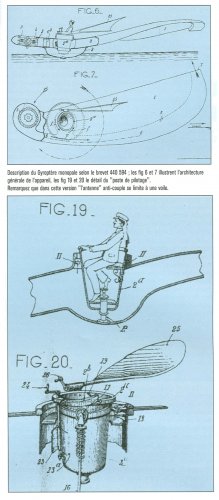

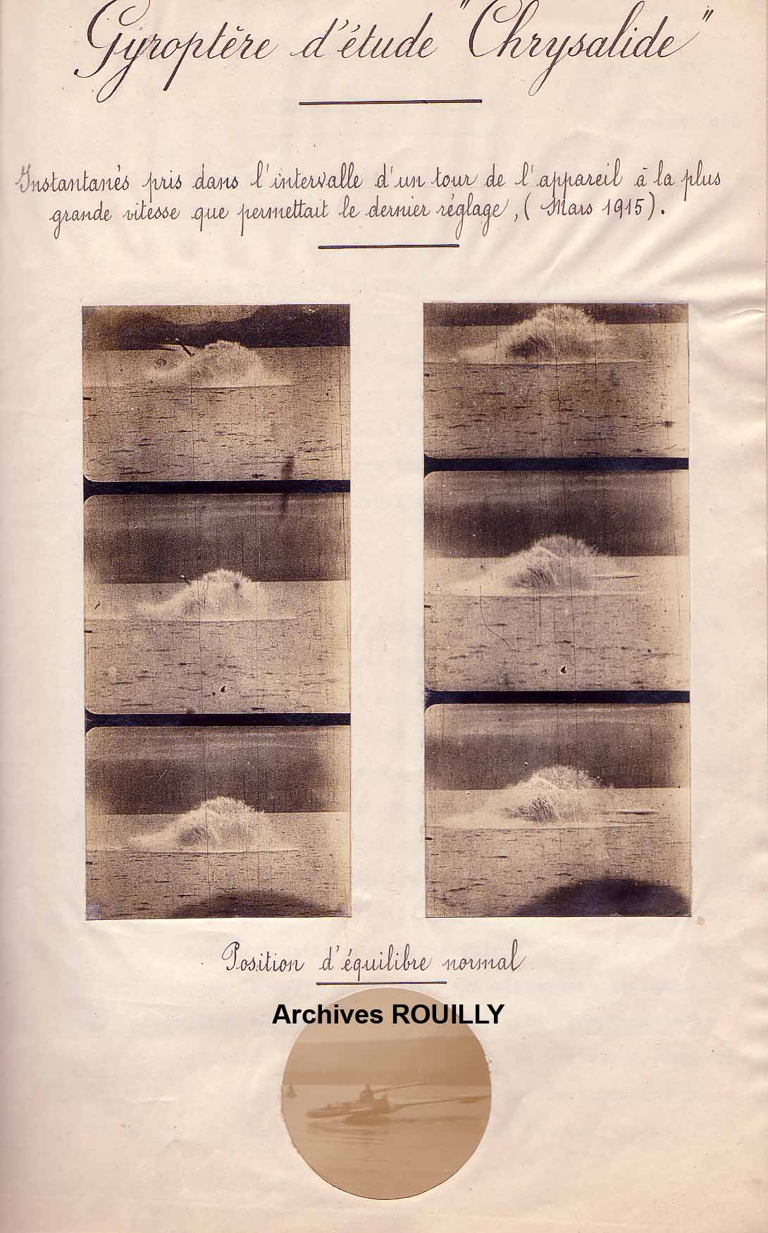

Check these pics which I gathered from an excellent article published in Air Magazine 30 (a publication which I warmly recommend):

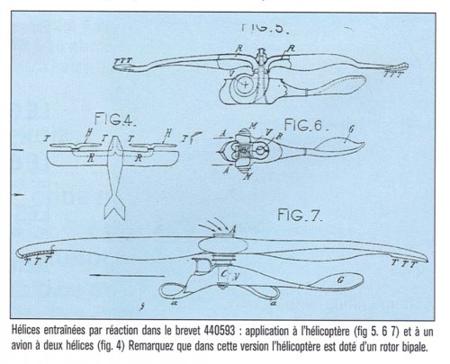

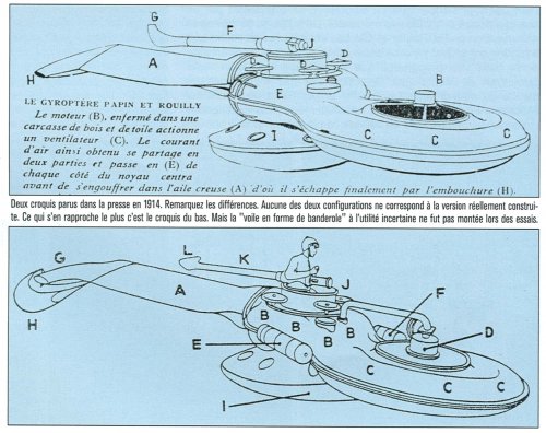

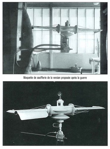

Post-WWI developments were even considered, some more of the helicopter kind... The last of these was the 1933 Model D for observation.

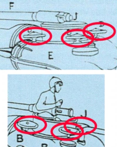

Thanks for those pictures, especially for the patent drawings. What I still didn't get, is the way
the pilots tub should have been decoupled from the turning machine. That vain shown, to my opinion
could only be helpful during forward flight and probably would have needed considerable speed over
ground, I think. Ther are a kind of rollers shown in the drawings, perhaps they were used to couner
rotate the cockpit ?

A while back, I did my best to do a write up on the Papin-Rouilly Gyroptere. As near as I can tell, the four rollers were spaced evenly around the pilot's nacelle. The only thing I can think they would be for was to help center and stabilize the nacelle. It is not quite the configuration from the patent, but the machine was fairly different overall.
Here is my attempt:
http://oldmachinepress.wordpress.com/2012/09/06/papin-rouilly-gyroptere-gyropter/
And I always get a chuckle out of this collage. That is a brave "pilot."
Fantastic page and documents, William. Can't believe this one escaped me before!
Are you the person behind the Old Machine Press site, or just a contributor?
Anyway, thank you so much for this great contribution.
Thanks for the link, Bill !
Interesting inside into this project and my question is answered, too !

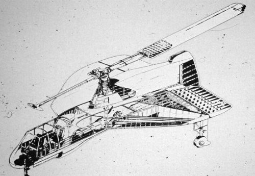

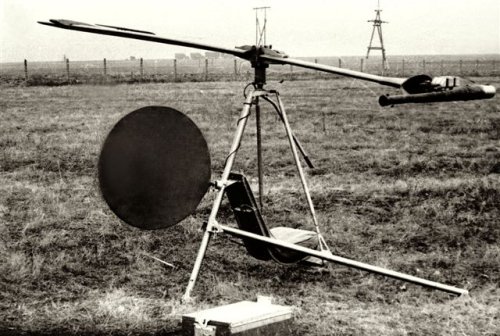

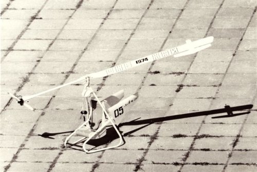

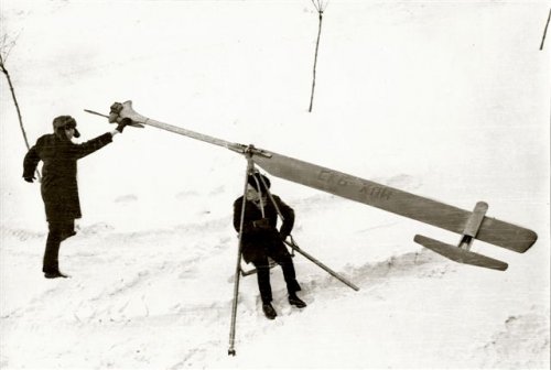

A question to close: could the Gyropter be considered, in a way, as a long-distant ancestor to the ill-fated Sikorsky XV-2?
It probably was the first attempt to realise a single blade rotor craft, so I would say "yes"
If carefully balanced, such an aircraft should be possible, I think. For me it's just hard to see
the reason, why the pilot was seated inside that machine and not just under it. More ground clearance
and a much simpler layout, I think.
