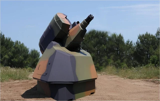

I found a couple of interesting pics of the system.
Its certainly a very compact little system

Does that mean it entered service with Italy? It's said it was developed for an Italian Army requirement, presumably following experience in Iraq/Afghanistan. Did they take it on trials as a UOR?
IIRC Centurion has a defended diameter of about 1,000-1,200 meters. This appears to use the short barrel M61, though the drawing shows a long barrel, so yeah. If you could mount this on a Humvee or a HMT trailer it would be pretty nice. The 8x8 installation just looks like a wimpier Phalanx though.
Even on an 8x8 it's a lot more compact than Centurion, which comes in a flat-bed trailer with a 6x6 prime mover. Of course, it also has an operator cab and generators on that trailer.
This is probably not as good a C-RAM solution as Centurion, thanks to the off-mount radar and no closed-loop spotting. But it's also a lot.ore portable.
