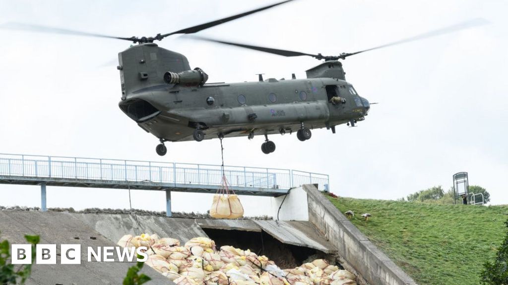

I live a few hundred yards from that dam (and fortunately a couple of hundred feet higher up the hillside), so over the past couple of days have been treated to the sight and sound of Chinooks in an almost continuous shuttle during daylight hours, bringing bags of stone and sand as reinforcement. Oh well, at least that huge fleet of Chinooks bought as a result of the public outcry over the lack of air transport in Afghanistan is being put to good use. I should add that the coordinated response of the emergency services seems to have been excellent - fast and appropriate - and the Chinook crews are doing a great job.
The reason the dam failed was a period of torrential rainfall, overfilling the reservoir and overflowing down the slipway (as designed) but with such force (the term "raging torrent" is not an exaggeration, if you've seen the video) that part of the concrete capping protecting the largely earth dam was torn off.
The dam was maintained and checked frequently, and has in the past been drained down for repairs, so it doesn't seem that maintenance was shirked. The dam seems to have been in OK condition, but it was an old design (it was built c.1830) and the ferocious weather evidently pushed it beyond its limits.
As well as the helos filling the hole in the dam, several powerful pumps are trying to lower the water level to below the lowest part of the damage, to allow people to return to their properties. Less than a quarter of the 6,500 residents have been evacuated (most of the houses are above the valley floor) but almost all of Whaley Bridge's facilities - shops, offices, workshops, pubs, the surgery and the library, the railway station and bus stops - are down in the valley floor and closed till further notice. So are most of the access roads, including the main road through the centre.

An update - about one-third of the water in the reservoir has been pumped out, and the feared heavy rain missed Whaley, so things are looking better. The authorities reckon that another couple of days of pumping should reduce the level down to the targeted 25% of capacity, which would make it reasonably safe. Evacuees should be allowed back to their houses later this week. However, there is still heavy rain forecast which may or may not hit us.
What will happen in the longer term is hard to say. Obviously the reservoir will be empty for years while the dam is redesigned and reconstructed, assuming the money can be found. In the meantime, operating the canal the reservoir feeds will clearly be a headache and the sailing club won't be able to operate, so tourism might suffer. An alternative would be not to reconstruct the dam, but convert the reservoir into a large extension of the town's green park.

In my very humble opinion and not being a civil engineer, the only way for the concrete blocks to fail in the manner they did is for water to infiltrate the earth and clay fill. This would mean the dam failed due to age and poor maintenance which is unlikely to be proven. There are a great many dams of similar age so perhaps we can learn something. I hope.

The visible damage doesn't necessarily confirm water infiltration, although that's the standard failure mode for such dams. The voids under the slabs are more likely the result of scouring once the slabs failed (remember the face of the dam, where the failure occurred, will normally be dry). Why the slabs failed is the question. It could indeed be water infiltration, but that is not in itself evidence of poor maintenance. The dam was subject to an extraordinary level of rainfall (and remember the dam will concentrate the surface run-off from its entire catchment area) and that may simply have taken it far outside its design limits. To give some idea of the kind of force possible, my father, the civil engineer of the family, reported seeing flood waters in similar terrain readily picking up boulders the size of an adult torso. And by the time he retired in the 80s he said he was certain they were getting 'hundred year storms' at least once a decade.
TLDR: It might not be a failure of maintenance, it might be that the standards we built dams to, and controlled maintenance by, are now obsolete.
