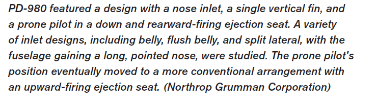

P.999 was the same as MX-324 ?!
I think they were a separated two series,because P.999 was appeared in
1942/43 and PD-980 from 1948.
