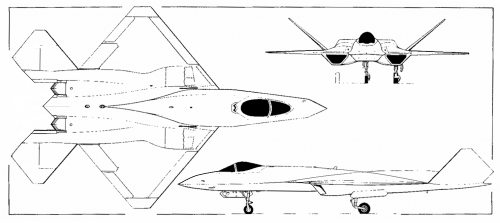

Here is what I modified YF-23 drawing, it will be more acceptable.
:D

My dear friend:
you'd better know what was you said equal factually is dissimilar.
foreplan could be smaller than horizontal stabilizer so the structual weight will be reduced.
foreplan will give a smaller balanced drag than conventional horizontal stabilizer, no matter where the barycenter you put.
the area of delta wing adapt to the foreplan will be bigger than conventional layout so give more lift the maneuver needed.
As I've stated before, canard aircraft tend to be lower cost, because they tend to have lower weight, for the mission, precisely because you don't need the tail structure that a conventional aircraft requires.
However, most modern fighters are unstable. As such, the canard is usually sized to push the nose down at high alpha. That means the canard is working against the wing. Whereas with the conventional tail it provides lift to keep the nose down in the same regime. As such, it turns out there are areas of the envelope where the canard can't trim the aircraft as effectively because the conventional tail offers advantages in sizing in this part of the regime. This is one of the reasons why Lockheed's F-35 went from a canard design to a conventional tail. There are other areas of the envelope where the conventional tail is better as well.
However, for many nations, cost is the number one driver, which was one of the primary design drivers for all of the new European Fighters having been built as canards instead of conventional tail configurations.
??? Did I lose someithing in the conventional tail offered? What's the advantage compare with the foreplan? You keep nose down, I keep nose down either.! :p ::) 8)
