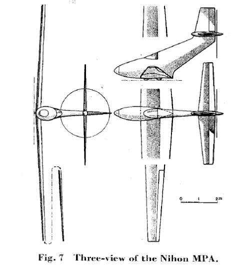

NM-63-69 Linnet series - Man-Powered Aircraft (MPA)
- Linnet series: 1966-1971 low-wing monoplane, tail pusher prop
-- http://www.flightglobal.com/pdfarchive/view/1966/1966%20-%200617.html

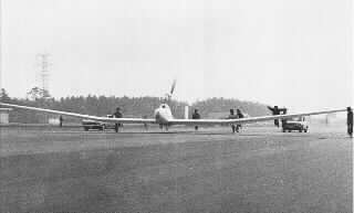

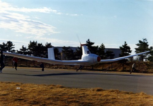

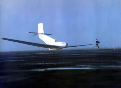

NM-63 Linnet I --- Feb 1966, 22.3 m span, 26 m2 area, 5.60 m long
- Linnet I: Longest man-powered flight was 43 m
NM-66 Linnet II -- Feb 1967, 22.3 m span, 26 m2 area, 5.80 m long
- Linnet II: Longest man-powered flight was 91 m

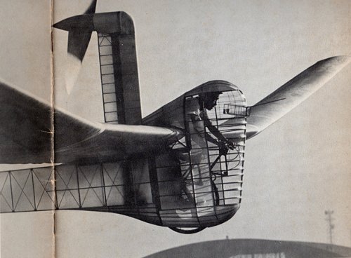

NM-69 Linnet III - Mar 1970, 25.3 m span, 26 m2 area, 5.86 m long
- Linnet III: Longest man-powered flight was 31 m
NM-?? Linnet IV -- Mar 1971, 25.3 m span, 26 m2 area, 5.80 m long
- Linnet IV: Longest man-powered flight was 60 m

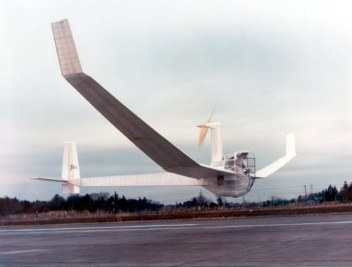

NM-72-NM-74 Egret series - Man-Powered Aircraft (MPA)
- Egret series - 1973-1974 low-wing monoplane, pylon prop

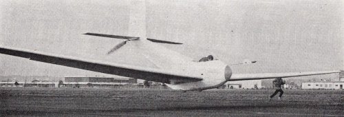

NM-72 Egret I --- Feb 1973, 22.7 m span, 28.5 m2 area, 7.40 m long, flown 34 m
NM-73 Egret II -- Oct 1973, 22.7 m span, 28.5 m2 area, 7.71 m long, flown 154 m
- Egret II: aka , aka 'New Egret'

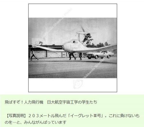

NM-74 Egret III - Nov 1974, 23.0 m span, 28.5 m2 area, 7.70 m long, flown 203 m
N-75 Cygnus II - [??] Reported by Aviastar (but desig. no. as per Stork)

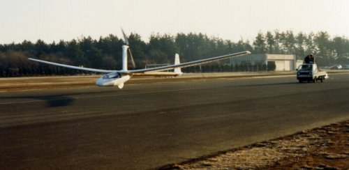

NM-75 Stork series - Man-Powered Aircraft (MPA)
- Stork series - 1976 high-wing monoplane, taller pylon prop

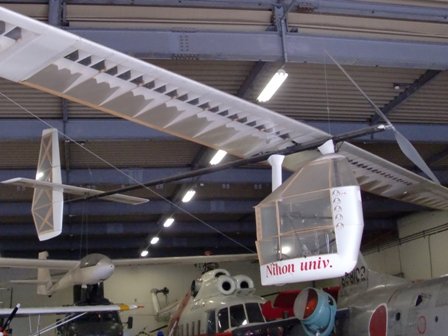

NM-75 Stork A - Mar 1976, 21.0 m span, 28.5 m2 area, 8.85 m long, flown 203 m
- Stork A: Original airframe (wheels propelled for T/O)
NM-?? Stork B - Nov 1976, 21.0 m span, 28.5 m2 area, 8.85 m long, flown 203 m
- Stork B: Stork A airframe with modifications

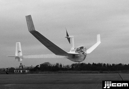

N-/NM-?? Ibis - MPA, 19.4 m span, 18 m2 wing area, 7.8 m long
- Ibis: 1978-1980 MPA, layout similar to Stork, flown 1100 m

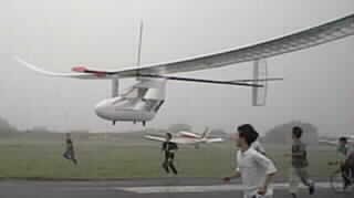

NM-?? Mowe series - Man-Powered Aircraft for the Birdman rally
NM-?? Mowe I ---- 1984-1985, 16.0 m span, [n/a] area, [n/a] long
- Mowe I: canard config., wire/wood construction, flew 14.1 m
NM-?? Mowe II --- 1984-1985, 18.0 m span, 24.9 m area, [n/a] long
- Mowe II: tubular CFRP/strut-braced wing, flew 52.8 m, trans. prob.
NM-?? Mowe III -- 1985-1986, 18.0 m span, 24.9 m area, 3.7 m long
- Mowe III: struc. as II, 3-axis controls (difficult), flew 90.2 m
NM-?? Mowe IV --- 1986-1987, 19.0 m span, 26.6 m area, 3.3 m long
- Mowe IV: winglets, flew 435.5m (against a mild headwind)
NM-?? Mowe V ---- 1987-1988, 22.0 m span, 29.7 m area, 3.5 m long
- Mowe V: 1987-1988, hollow CFRP box-spar wing, unsuccessful
NM-?? Mowe VI --- 1988-1989, 22.0 m span, 22.1 m area, 3.5 m long
- Mowe VI: wing wire-bracing stiffens fuse, 13th Birdman canc.
- Mowe VI bis -- 1989-1990 25 m span, 24 m2 area, aka Mowe VI-B
NM-?? Mowe VII -- 1989-1990, 22.0 m span, 22.7 m area, 3.3 m long
- Mowe VII: used Mowe VI spars, DAE11 airfoil, flew 1810.5 m
