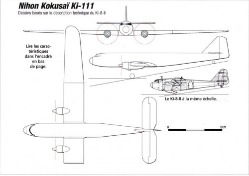

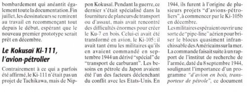

Jemiba said:
here is from Le FANA 425,the Tachikawa Ki-111,but they wrote Nihon,
and on the article they wrote Nippon,I don't know what was this confuse ?.

and here is from Le FANA 425,the Tachikawa Ki-111,but they wrote Nihon,
Nihon Kokusai Koku Ki-111 oil transport plane
The No.1 IJA aviation technology research institute drew up the oil transport plane plan named Ki-111 in September 8, 1944.
Based on this plan, the Imperial Japanese Army pointed to the trial production of all wooden oil transport plane to Nihon Kokusai Koku.
This fuel transport plane aimed at the fuel transportation from the south, and had 13000 kg pay load and 10000 km or more in cruising range as demand performance.
The research of this fuel transport plane was started from September, 1944. As a result, following design policy was set up, and design started.
(1) The body of the Ku8 transport glider under trial production was enlarged and applied to this oil transport plane.
(2) The engine of this oil transport aircraft was HA 211.
It did not realize, although producing 100 sets of this oil transport plane 1945 was planned.
