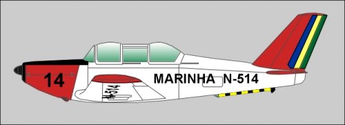

here is the Brazilian Marc Niess series of aircraft and projects,the 1-80
was side-by-side two seat high-wing monoplane,powered by one 80 hp engine,the 2-100 was three seat variant of (1-80) powered by one 100 hp engine,the 3-150 was all-metal four seat with swept forward wings and
powered by one 150 hp engine.
The designs 4,5 & 6 are not known,the 7-250 Fragata was tandem two-
seat trainer aircraft project,the later was the last creation for CBA
(Companhia Brasileira de Aeronáutica).
Flying Review 11/1956
http://www.naval.com.br/anb/ANB-historico/ANB-hist16_avioes_da_MB.htm

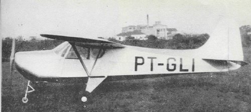

I think that only the 2-100 was actually built with reports that 2 examples were constructed (PT-GLI and PT-ZPE)
Attached a photo of PT-GLI and some text.
2-seat sport
one 100hp Lycoming 0-235 piston engine
max. speed 115 mph, cruise 105 mph, ceiling 16,000ft
wingspan 31.625ft; length 21.458ft
DETAILS: The Model 2-100 design of Mr. Marc William Niess was more or less a tricycle u/c version of the Maranhao, but also differed in other aspects, including the installation of one more powerful 100hp Lycoming O-235 engine and the use of slightly forward swept wings. The first of 2 prototype aircraft made the first flight in 1952. Further development was halted.
Production: 2

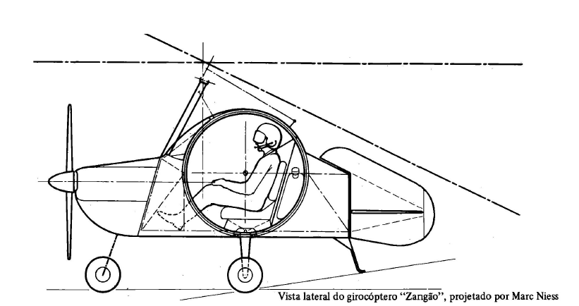

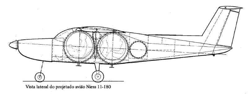

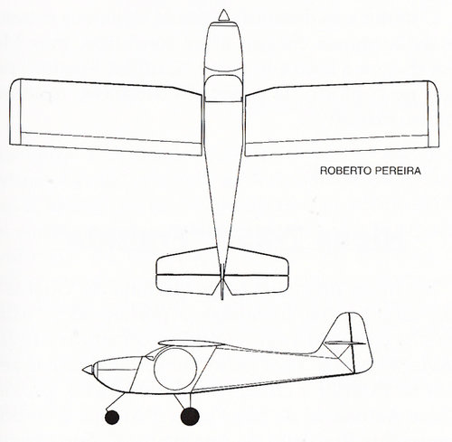

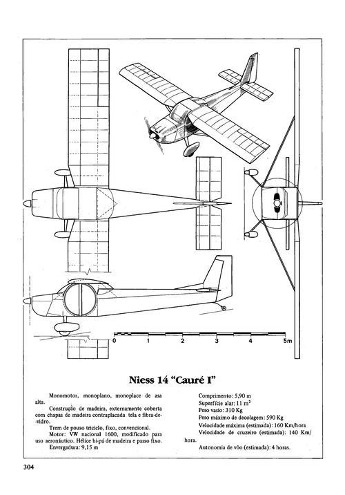

From, Historia da Construcao Aeronautica no Brasil,
here is a twin boom Project,maybe 8-?,and a small Info about
Niess 9-80,11-180 & 12-300,also a gyrocopter,maybe it was a
10-?,finally the 14-I Caure I.

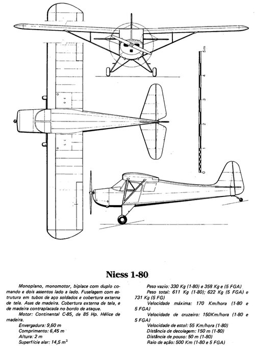

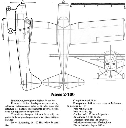

Here are 3-views of both really built Niess airplanes.
From Historia da construcao aeronautica no Brasil, Editora e Distributora de Livros Ltda, 1982, p. 158 and p. 160
