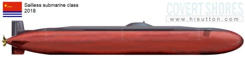

Estimated at 50m long by 5m, low profile with no top mast.
(Image from Jane's)
